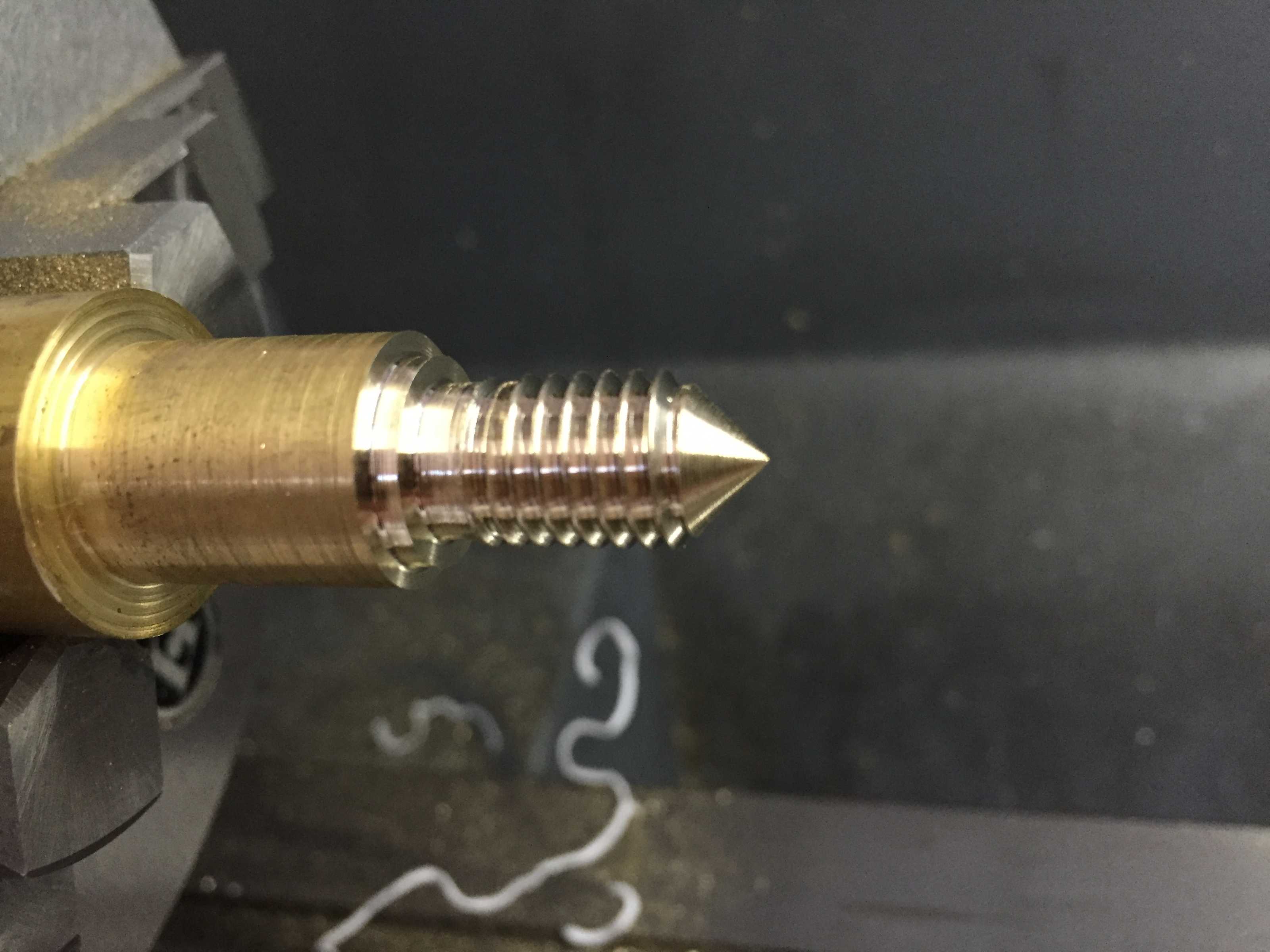

Joe - Thanks for that - it really confirmed what I was thinking.
So I kept the quadrature encoder as it is and adjusted the scale to 4114 (up from 4096) based on 20 hand revolutions of the spindle and dividing the spindle count by 20.
I added this for the index pulse:
and as you can see the results are much better:
Here's the video as well.
Thanks for everyones help!

Looks great.
May I suggest starting your thread at Z.100" or even Z.200" to be sure everything is up to speed at the actual thread.

If you are using Linux CNC 2.7.0 and get crappy looking exit moves at the end of the thread when using an exit taper (E>0 in the G76) - put an F0 prior to the G76. This will give a nice clean threads at the exit that progressively reduce in depth. If exiting into a relief groove using E0, you won't see this problem.
Looking at your video there definitely seems a pause at the end of the thread prior to the exit - but that could be you are just using E0 too with no relief groove.
Bug found in new trajectory planner which looks like it will be resolved soon. forum.linuxcnc.org/forum/20-g-code/29685...aper-linux-cnc-2-7-0. 2.6.x does not have this issue.
Looks like you have been having similar fun to me by converting a machine that was not really designed to do this. Mine even less so being a Sherline! But haven't had to put the change gears on since!
Have fun!

I normally don't use exit taper or relief groove. With CNC you can run threads right up to a shoulder and retract reliably in a fraction of a spindle revolution.
You may need a relief groove in some cases to allow the mating part to pull up tight, of course.

I'm using tormachs pathpilot version which is based on 2.6 so I haven't see any weirdness that I didn't cause myself
