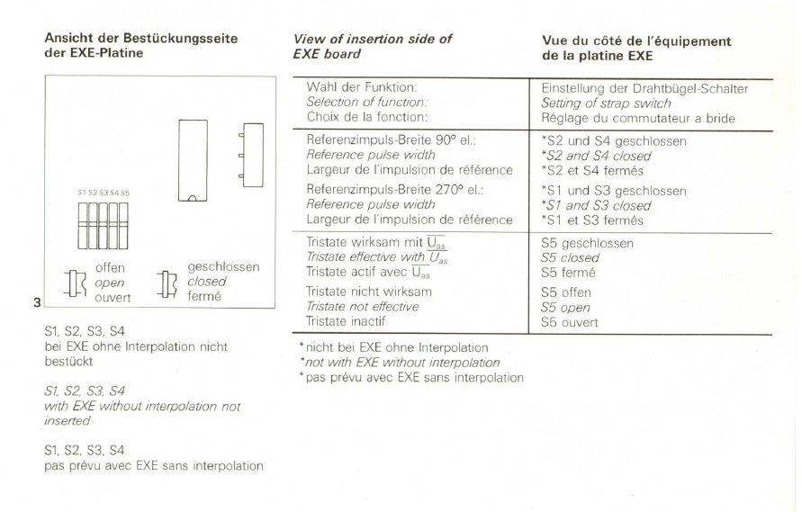

I am doing a refit of a Bridgeport Interact mill and have some EXE 602 boxes to convert the 11us sine wave signal to TTL. The 602's have 5 jumpers inside to set configuration options. For the life of me I cannot find anything about these. The manuals have excruciating detail about everything but these jumpers. Anyone out there have information about the jumpers?

The manuals indicate that the box can be configured for no interpolation or 5 fold. Also the width of the fault detection pulse, and the index pulse can be configured. There is also an option for tristate for the outputs if there is an error. I can figure out the settings with a scope if I have to. It's really odd that the manuals offer a lot of detail about the options with nary a word about how to set them.

At last I found what I am looking for. The only manuals I could find were for for an exe602E and I have exe602D's. I managed to find the manual for the exe602D and on page 18 are the jumper settings, Hallelujah! The first two jumpers are used to set 0 or 5 fold. My 4 exe602D's were all set differently and mostly incorrectly so it would have been a pain to sort this out without the manual.
I am not sure if the exe602E has the same jumpers, but the manual certainly implies the the unit has configuration options.

07 Jan 2016 15:05 #68017
by csbrady
Replied by csbrady on topic Heidenhain EXE-602 Configuration
The following user(s) said Thank You: Willemsjos
