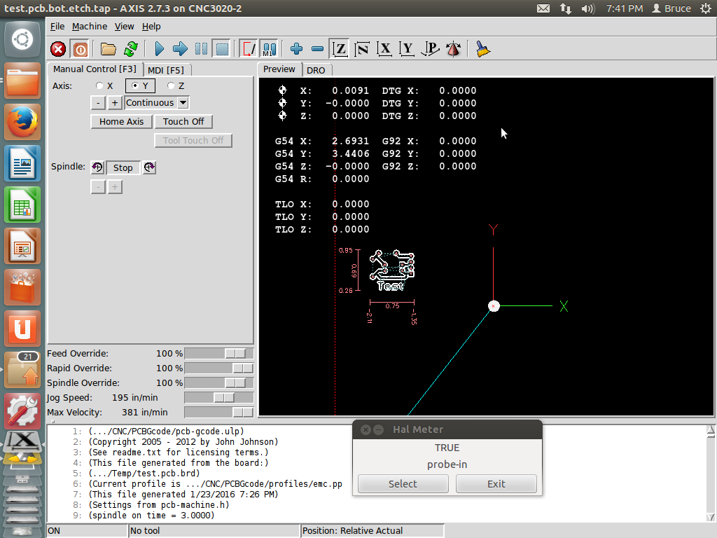

24 Jan 2016 18:04 #69063 by spinnaker
Replied by spinnaker on topic Need tool prepared -txx for toolchange?
I have to touch off -2.11 inches to get the X axis to line up. See screen shot attached. Should I not just have to touch off at zero? Or is adjusting the touch off point fairly normal?
24 Jan 2016 18:26 - 24 Jan 2016 18:46 #69064 by spinnaker
I think I got it. I actually have to touch off something like -1.01 inches to get it to start etching where I want. I guess I will need to read up on coordinates.
