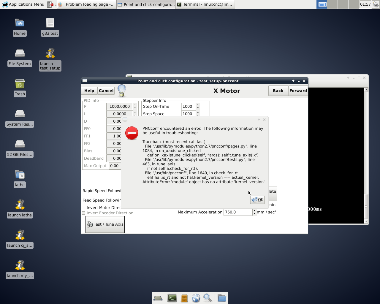

03 Nov 2016 23:01 #82402 by vmihalca
Replied by vmihalca on topic Mesa 7i76e setup help!
When I'm setting up the axes and I try to test the axis, I get this error message. Any idea why? :(

05 Nov 2016 16:07 #82495 by PCW
Replied by PCW on topic Mesa 7i76e setup help!
The PnCConf bug is a known problem on Preempt-RT kernels
You might ask if/when this got fixed in the PnCConf forum section
