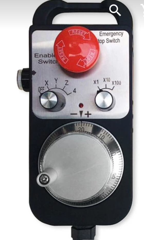

For the pendant, I have connected the Z and X wires to 22 and 23 pins.
So basicaly is +12v --> switch --> pin22. When the switch is closed, pin 22 or 23 are reported as true in hal meter.
Now, for the mpg encoder, the inputs are 16 and 17.
If I put a switch just like for axis selection, the value of hm2_7i76e.0.7i76.0.0.input-16 pin goes TRUE when the switch is closed, which is correct! So again I have +12-->switch-->pin16.
The thing is that the mpg needs to be powered at 5V, so I'm using a 78M05 circuit, to transform the field input to 5v.
Now with the circuit connected, I can power the encoder with 5v. But now between GND and A+ or B+ i can measure 3.65v or aprox 0V. The thing is that with 3.65v the pin does not goes to TRUE. In the documentation it says that the threshold is 2.5v so I assume anything greater than that can be considered as TRUE.
I'm quite newbie with electronics, so If I'm doing something wrong, please let me know!
In a previous post (PCW I guess) was saying that once I set the mode to 2, I should check with show pin if mpg shows up.
In the listed pins I have not seen any pin containing "mpg". Is this ok?

This is expected, the digital input bits still have the ~ 1/2 VFIELD threshold, _but_ the MPG quadrature
encoder pins have a 2.5V threshold
The pins will be like:
hm2_7I76e.0.7i76.0.0.enc0.count

02 Dec 2016 11:39 #83568
by vmihalca
Replied by vmihalca on topic Mesa 7i76e setup help!
Thanks to your advices, I have managed to wire the encoder in the picture below and see the dro changing when turning the mpg.
As you can see in the picture, the pendant has an enable button on the left side. When i select the axis or increment, the circuit is closed only if I push that button.
I don't have any previous experience with cnc machines or pendants so don't know how that enable button should behave.
Is it a feature to be able to jog the machine axes only when enable button is pressed?
If not, i could change the wiring and use that button for smth else, however the wiring diagram&wire colors don't match the device itself
China $60 piece of equipment!
