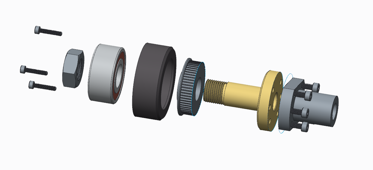

Well, you also need some sort of thrust-bearing arrangement for the ball-nut to rotate inside too.
But there are lots of cheap car wheel-bearing sets in the right sort of size.

Yeh, that makes sense. I've got some trailer bearings somebody gave me. I might need this one day...but currently my rack and pinion drives are working nice on my machine but we are talking 21 m/min for plasma.... I'd love to see a sketch or cad drawing

22 Feb 2018 12:01 - 22 Feb 2018 12:02 #106331
Replied by rodw on topic 2 gantries with a shared work area
Never mind, found one
www.nzbzd.com/Rotating-Ball-Screw-Nutxjfckbub
I think the dark bearing cup needs to be pressed into the gantry.
I've actually got some M30 x 2 threaded rod and matching half nuts that might nearly be big enough to machine some sort of tapered bearing mount out of

22 Feb 2018 12:08 #106332
Replied by andypugh on topic 2 gantries with a shared work area
a360.co/2dJNHJ7
The X drive is the one hanging about in space all by itself. The Z is at the back (I can't seem to change the "home" view to suit the actual machine orientation)
Both are far from being the simplest possible arrangement. The X especially is over-complex as I was trying to keep it short so the bearing, pulley and ballnut are all one inside the other.
