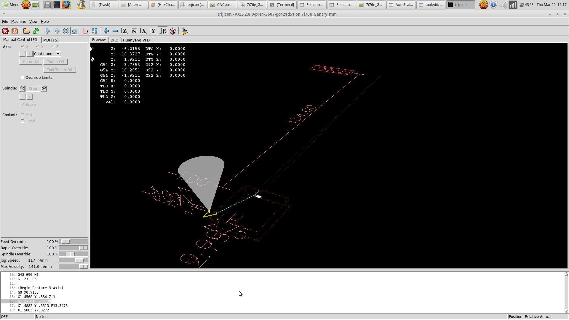

22 Mar 2018 16:18 #107738
by DanMN
Replied by DanMN on topic Newbie question
My comment on the scale was due to this picture -- notice your part is that tiny tool path in white, and for some reason your are getting gcode that tells you your toolpath includes a point 133 inches north in empty space. I don't have any explanation for that, but your original line 11 had a Y value that required a line wrap on my wide screen monitor -- I gave up looking after a few dozen digits. That's the value I shortened from 133 bazillion to just 133.
