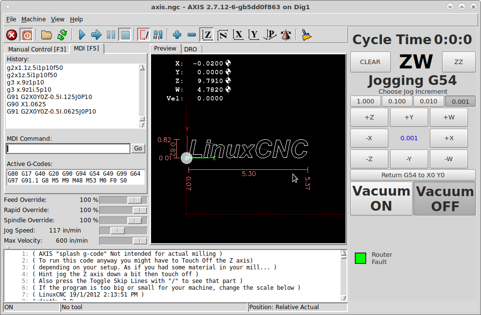

I really appreciate all the help. It's late, so maybe I'll feel different in the morning. But at this point, it really seems like my friend and my instincts were exactly right. LinuxCNC is fantastic if you are building your own CNC machine and want to deliver it as a package with machine control software. Then all this up front time investment is worth it. Or if you are doing something really custom. Or if you just hate Windows so much that you can't tolerate the idea of using it. I hate Windows too, but I've already put a bit of time into this (more so because of my unfamiliarity), and at this point it logically makes sense to spend more money (about $150 more) and get UCCNC and an add-on screenset for $25 and tolerate Windows and be done with it.
I don't understand why if 2.8 existed in 2016 (based on the thread about updating to it), that there isn't an ISO for it that just works. And why the graphics in Gmoccapy are so screwy WRT to scaling, I just don't understand. Regardless of the settings. I wasn't running it full screen. Maybe they are fixed in 2.8 but I can't know by just finding and ISO and running it.
And I haven't even gotten to thinking about configuring actual HW. Which seems like will be easier on 2.8, based on your comments about a machine like mine that has two x motors.
In case you think my difficulties are because I'm not tech savvy, I'll point out that I've been an embedded systems designer and DSP guy for about 35 years now. And I've done paid programming projects on Linux, cross developing from both Windows and MacOS. I'm competent in many many programming languages, including extensive assembly coding and chip design in VHDL.
Maybe I'll feel differently in the morning. But right now my instincts are to cut my losses.

Thanks for the most recent input guys. I think it logically concludes this attempt. I would really have liked it to work. Not primarily because of the money, but because I'd really like to be done with Windows and I do like open source when it works. I'm actually surprised about how close I got. Rodw pointed out that I got led down the wrong path and wasted some time and I think that is right. Actually, I only briefly tried stuff on a VM so that really isn't it. And my laptop is a pretty generic Toshiba a few years old with a standard size screen, so the graphics problems are mysterious.
In the end the showstopper is Axis. It is IMO a pretty bad UI. I know people use it successfully, but it is inferior to the standard screen in both Mach3 and UCCNC. And custom screens are available for both those systems because folks are unjustifiably not satisfied with those screens. I know that new UIs can be created in LinuxCNC, but I don't have the time. Actually, my CNC friend told me that Tormach has their own nice UI on top of LinuxCNC.
He's also the one that warned me that LinuxCNC would be a time sink. And BTW he has no financial interest in UCCNC whatsoever. He just had to get away from Mach3 just like me and ended up with UCCNC. He actually dove further into HAL and UI creation and so forth.
If Gmoccapy didn't have the problems it has, and if it had an interface for x/y/z auto touch off based on a probe, I would keep pursuing LinuxCNC further. But I think I've reached the end of the road. At least I have the satisfaction of having given it my best shot.
Thanks to everyone!! I have nothing but great hopes for the future of LinuxCNC.
