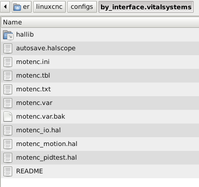

Are there other HAL files? That one has no connection from the PID to Xoutput (etc)
The following user(s) said Thank You: partec
- partec
- Posts: 173
- Thank you received: 27
10 Oct 2018 01:30 - 10 Oct 2018 10:22 #118612
by partec
Replied by partec on topic Motenc Lite
it is almost same as the installed example of the image distribution 2.7.14
