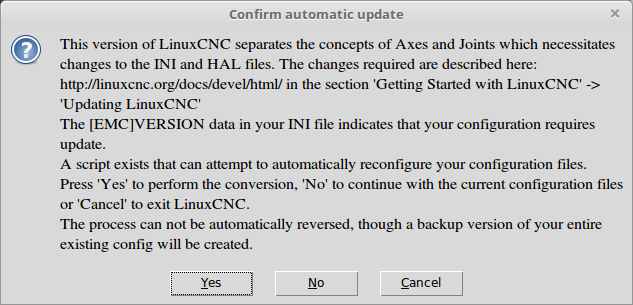

I've waited a bit over a week but haven't heard any discussion about these problems. I recently updated my EO branch and things haven't been going smoothly. Please look at the state of the commits I have installed:
Every time I start LinuxCNC I get the following message box popup:
Then on top of all this when I look in the terminal that I started LinuxCNC from it is flooded with these measages;
This is the last little bit, after the upgrade I am getting this message in the terminal when I am setting up my work piece ( I haven't changed what I do and never had these errors before):
I do have my system running after chasing down all the new spindle names in my pendant hal files and fixing them.
Will all this be fixed with the next update? When will pull request #509 or apparently renumbered to #512 be included in an update?

826232c Multispindle: CLean up some commands that needed a spindle choice but lacked oneEvery time I start LinuxCNC I get the following message box popup:
Before: spindle 0 speed 0.000000
Before: spindle 1 speed 0.000000
Before: spindle 2 speed 0.000000
After: spindle 0 speed 100.000000
After: spindle 1 speed 0.000000
After: spindle 2 speed 0.000000This is the last little bit, after the upgrade I am getting this message in the terminal when I am setting up my work piece ( I haven't changed what I do and never had these errors before):
Emit interp-run
wrong motion mode, change to the correct one
(<__main__.gmoccapy object at 0x7f2e85f03b90>, <Dialogs object at 0x7f2e85f22aa0 (Dialogs at 0x346ed40)>, 'alert')
(<__main__.gmoccapy object at 0x7f2e85f03b90>, <Dialogs object at 0x7f2e85f22aa0 (Dialogs at 0x346ed40)>, 'alert')I do have my system running after chasing down all the new spindle names in my pendant hal files and fixing them.
John

Have you tried letting the conversion script run on your configuration files?
- Thank you received: 4652
01 Nov 2018 15:27 #119766
Replied by andypugh on topic New Problem
Can you zip up your config file and email it to me so that I can try to work out why the conversion script isn't "taking"?
What the script is trying to do is convert the spindle pin names for you.
But if it runs every time, something is wrong.

Hmm, islander261 has always been using master branch so for the conversion script window to trigger indicates there is something wrong with the logic in deciding if it should be displayed as he's never used Version 2.7.
- Todd Zuercher
- Posts: 4782
- Thank you received: 1472
01 Nov 2018 21:14 #119788
Replied by Todd Zuercher on topic New Problem
I believe that when the multi spindle feature was recently merged into master the upgrade script was changed and version incremented so that old configs (including JA Master ones) could be updated for the new changes.
- Online
- Posts: 18086
- Thank you received: 5321
01 Nov 2018 22:50 #119792
Replied by PCW on topic New Problem
Yes, the script is fixing the spindle section but its message still suggests its changing to joints/axis even if just upgrading 2.8
01 Nov 2018 23:06 #119795
The message is the same regardless.
I didn't see a great deal of point in making a new message for the relatively small number of people who are on V1.0 and need to upgrade to v1.1
