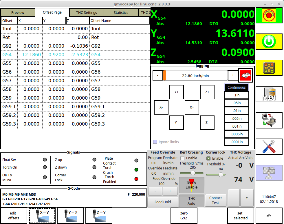

Ok, I did a little more testing. This part is now looking to be related to using Gmoccapy in some way. I am using version 2.3.3.3.
These warning appeared on the terminal when I set my work piece zeros.
The warning occurs when I press the X=?, Y=? or Z=? button at the bottom of the screen. The operation does end up completing with the desired results so I guess this is in the nuisance category of problems.
John
Emit interp-run
(<__main__.gmoccapy object at 0x7fb650438b90>, <Dialogs object at 0x7fb650457aa0 (Dialogs at 0x28b7240)>, 'alert')
(<__main__.gmoccapy object at 0x7fb650438b90>, <Dialogs object at 0x7fb650457aa0 (Dialogs at 0x28b7240)>, 'alert')These warning appeared on the terminal when I set my work piece zeros.
John

Replied by andypugh on topic New Problem
Sorry, I didn't find the time to look at this.
You can solve this by setting "VERSION" to 1.1 in the INI.
Why that is not happening automatically is what I need to fix for everyone else.

I think I have found the problem, the update_ini script does not handle ini-files with #INCLUDE statements.
I need to figure out how to fix that. It isn't looking trivial.

These are not warnings - these look like they are debug messages left in from work Norbert did recently.
unless you find something wrong, you can ignore them.

Actually, it was an easy fix, and has been pushed to Master.
