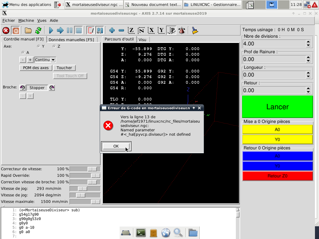

Replied by jefsaro on topic attempt to divide by zero
thank you very much, but I do not understand what I have to do, it exceeds my skills

The following variables should exist in your g code
So where you have
You might be able to replace it with
And likewise remove the other M66 /#5399 commands and use
I'm not sure that these pins will be there in a subroutine though so they might need to be passed as parameters to the subroutine.
Replied by rodw on topic attempt to divide by zero
#<_hal[pyvcp.diviseur]>
#<_hal[pyvcp.profondeur]>
#<_hal[pyvcp.Longueur]>
#<_hal[pyvcp.retour]>So where you have
M66 E0 L0
#2=#5399 (_nb_division)#2 = #<_hal[pyvcp.diviseur]>And likewise remove the other M66 /#5399 commands and use
#4 = #<_hal[pyvcp.profondeur]>
#7 = #<_hal[pyvcp.Longueur]>
#8 = #<_hal[pyvcp.retour]>
- jefsaro
- Posts: 110
- Thank you received: 4
07 Feb 2019 14:50 #125927
by jefsaro

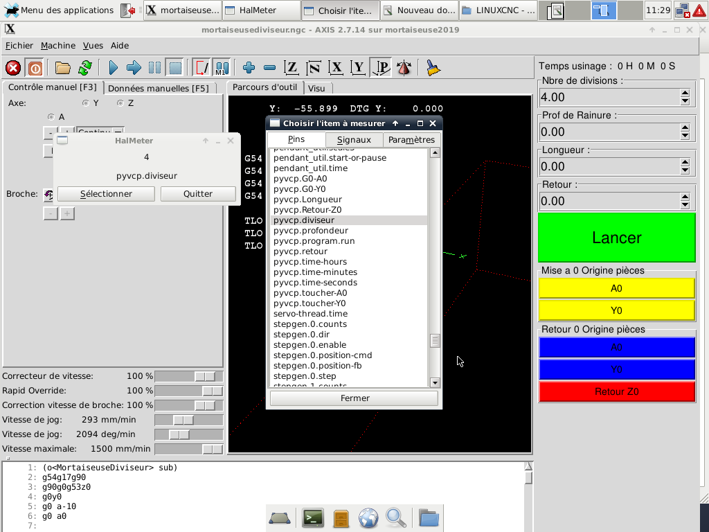

hello ,
i test , but i think i make a mistake , when a change it's ok in parameter , but i 'am error , parameter is not defined.
regards
jf
regards
jf
- Posts: 12149
- Thank you received: 4144
07 Feb 2019 19:31 #125945
Remove the spaces in the variable name in your gcode file and it might have a better chance of working
hello ,
regards
jf
