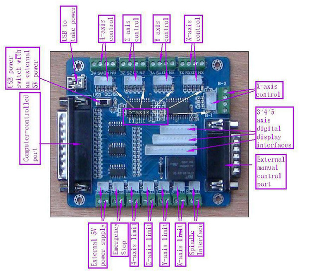

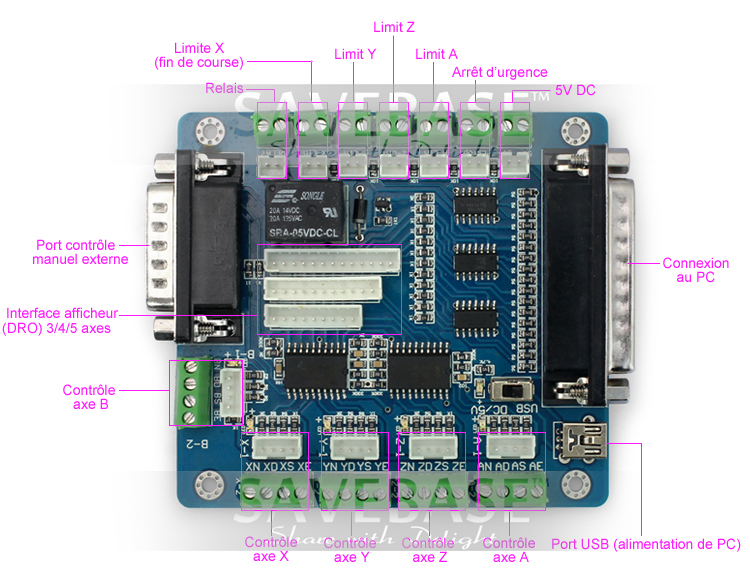

I also took a 750w Servo AC (fr.aliexpress.com/item/90ST-M02430-220-V...1.0.0.27426c37lEOIRs) to replace the original brushed motor. But that's where I dry for the wiring and the setting of this servo. I have two PCI ports on my PC. And a simple interfacing card (photo). So I scoured the web up and down (we find things but it's in English and sometimes rather technical) I understood that we could order the servo with STEP / DIR. But how to do with the encoder?

Thank you for your reply. Yes I saw that my driver accepts + -10v. But the post you shared with me uses a Mesa card and I do not have one. I have this card (www.usinages.com/data/attachments/187/18...dedff43f8636891b.jpg) or the one (www.gbeshop.com/InfoBase/SAVEBASE/PKG/00...7665pan22_franch.jpg)
Is it absolutely necessary a Mesa card to use this damn servo: /?

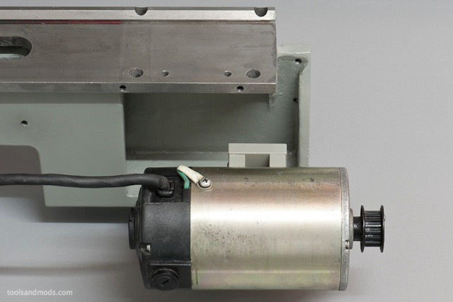

The motor I want to replace is this one (attachment) 500w it seems to me and 3000 rpm maximum. My servo is a 750w 3000rpm too. I chose an AC servo for its size. It's a little ride so not much space for an motor.
Apparently no problem to drive it by step / dir. As is the speed that counts for a pin. I need only one index, right?
Thank you
Sorry in advance if I do not understand everything at first but I have tinnitus quite noisy: / but I must continue my projects anyway ..

22 Feb 2019 22:44 #126961
by Mike_Eitel
Replied by Mike_Eitel on topic AC Servo
I can not see 0-10v with the board you showed. You need that to command the speed.
The other signals for 2 stepper and run/fwd for your servo can be done with such simple board.
