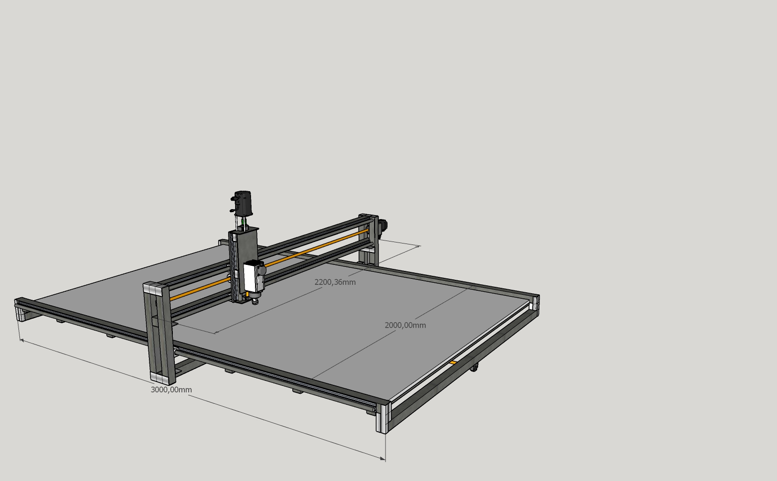

- Posts: 27
17 Mar 2019 18:16 #128839
by Tavares
Replied by Tavares on topic AC servo with 7i93 board
Tnx for the reply guys!
I'm thinking about the diameter of the ball screw. In the project I used ball screw of 16mm, I do not know if I need 20mm because it is a big machine 3000x2000.
Details
Mesa board: 7I77-5I25
Driver Ac Servo Driver: ASD-B2-0721-B (manufacturer Delta)
AC Motor: ECMA-C20807ES 750W Torque 2.39Nm, 3000 RPM - Encoder 17 Bits - Shaft 19mm (manufacturer Delta)
ball screw : 1605 (16mm )
Tubes 50x50x15
Iam thinking in change the ball screw to 2005 or 2010, what u guys think? I want fast and Strong
and without spending a lot of money.
Take a look at my projet
My CNC 3d-Sketchup File
Details
Tubes 50x50x15
