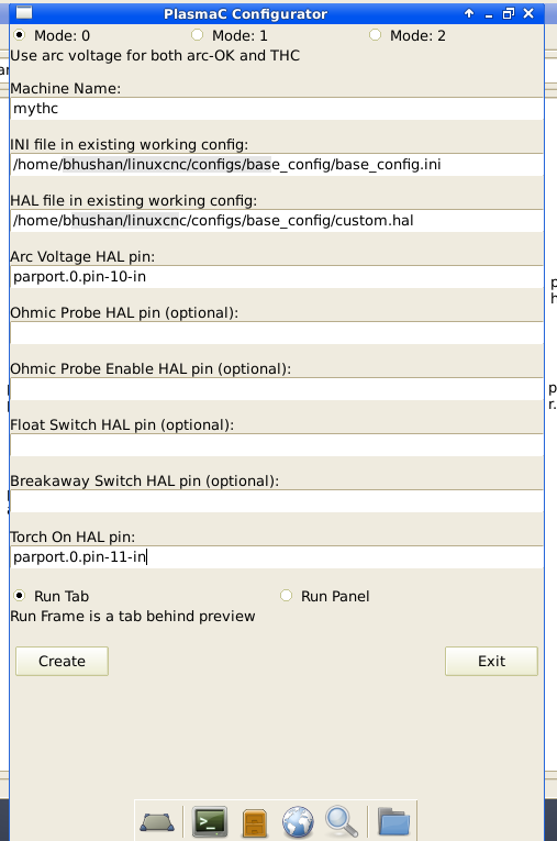

The error message says it all. You are trying to connect a type float pin to a type bit signal.
The plasmac.arc-voltage-in pin is a type float which means you can only connect it to a type float signal.
The error is in file my_plasma_connection.hal which you did not post so there is little we can help with.
John
John

It seems the problem is that you are connecting a digital pin (pin 10) which only has a on/ or off state to a voltage pin which is a float type. This type has a decimal point. This is not allowed. This makes sense as a voltage can't simply be on or off when we need to measure what the voltage is.
So the problem really is with your design, not plasmac.
The question comes back to: How are you reading your torch voltage on parallel port system?
You have not actually ever answered that question clearly. You need to do that if you are going to move forward.
You may be able to use a different plasmac mode to work around this.

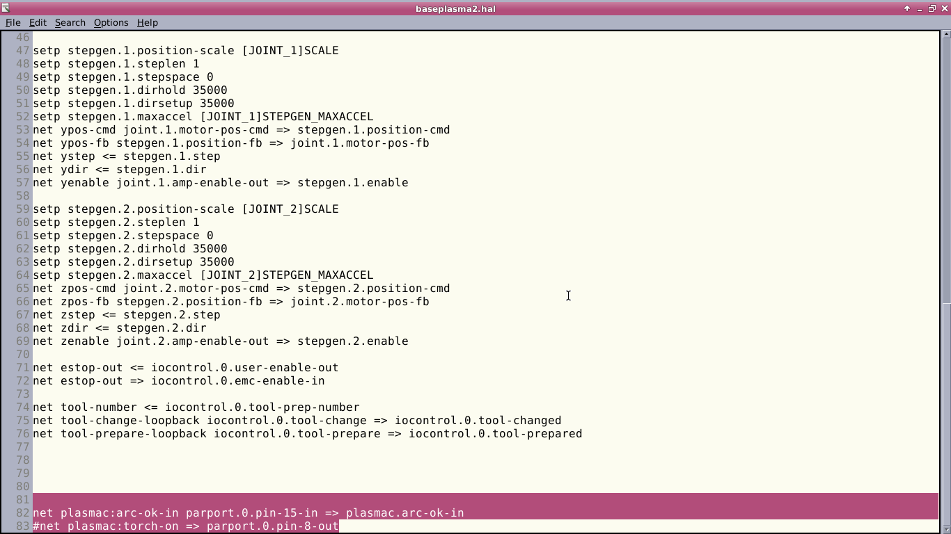

Yes, you need an output pin for the torch.
You also need an input pin for the float switch.
As you stated earlier that you don't have arc voltage yet just put anything in there for the time being and after you have finished the configurator edit mythc_connections.hal and comment out the line referring to arc voltage then you should have a running configuration without arc voltage.

Here is a tip: Always start linuxcnc from the command line. That way when it crashes, you can study the messages in the console window it usually will print a useful error. say "pin xyx does not exist". so then you know where to look. sometimes its useful to comment out the line that is causing the error so you can run Linuxcnc and use halshow to observe the actual pin names. It might just be a typo or something in your hal file. When you see what it should be you can fix it and remove the comment.

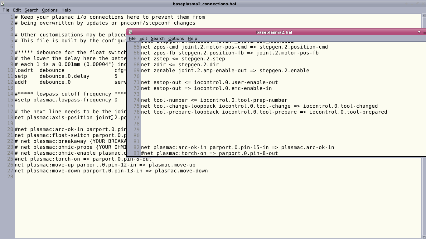

as someone suggested i commented out my arc-ok in and torch on out pins and my config runs but as soon as i uncommented them it says that resp pins not found
i moved my arc-ok in pin from baseplasma_connections.hal to baseplasma.hal and arc-ok in prob solved
but its still saying that parport.0.pin-8-out which is torch-on pin not found what can i do about that ???
