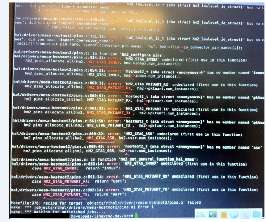

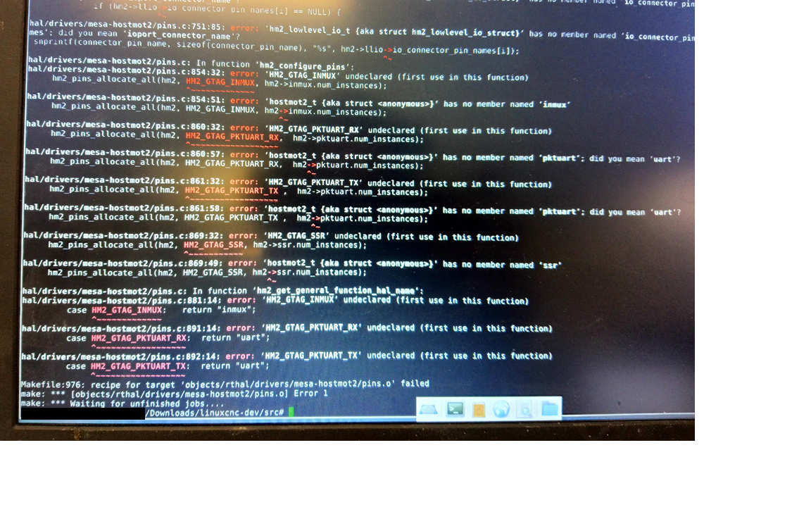

Hi PCW,
I've re-built the linuxcnc ( github.com/KurtJacobson/RF45-CNC/wiki/Bu...LinuxCNC-From-Source) after replacing the hm2_eth.c and pins.c files in the directory: linuxcnc-dev/src/hal/drivers/mesa-hostmot2/
When I tried to compile (make) the 2.7 branch I had multiple undeclared errors generated by the pins.c file.
So, I tried the 2.8 branch and It also generated errors but they were all related to the undeclared definition "HHM2_GTAG_INMIX". Then, I opened the pins.c file and commented the lines of code which use this definition and it worked! Please find attached the modified pins.c file.

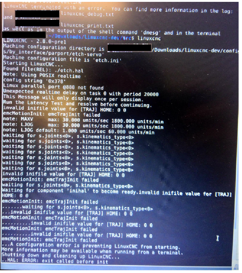

Can you please tell us what are you trying to achieve as the end result, it seems you keep trying to do things you really do not need to.
On the first screen you are using a config for a parallel port and your PC does not have one, at least not at the address it is looking for (0x378).

Hello,
At this point I want to create a configuration (Hal.file and Ini.file) that I can edit and adapt to my application.
However, I'm not sure if the re-built LinuxCNC 2.8 will work witth Mesa 7i94. So, I just selected a sample configuration to test it. It crashes when I select this : "Sample Configurations\by_interface\parport\etch-servo\etch"
However, this does not happen when I use the LinuxCNC 2.7, which is currently installed.

The first step would be to get a working 7I94 hal file, you will not get far with hal files for other hardware. I think I have a test config (for step-dir) you can try but I have to dig it up
Also here is the latest snapshot of Mesa HM2 changes:
freeby.mesanet.com/newmesa.zip
Note that this should be unzipped into the yourlinuxcnc-dev/src/hal/drivers/mesa-hm2 directory and the Makefile moved to yourlinuxcnc-dev/src
