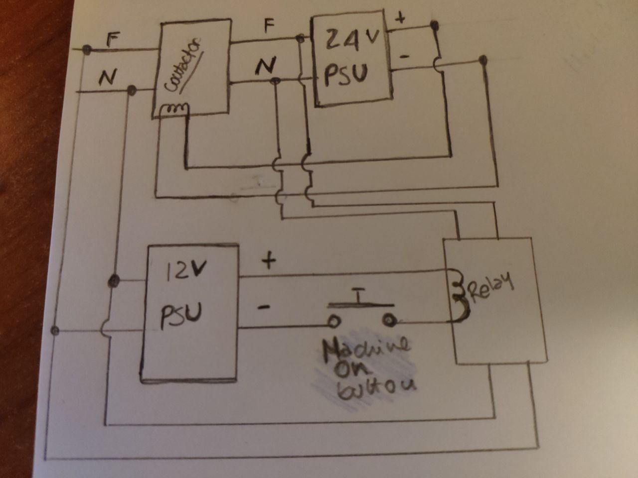

- Muz94
- Posts: 79
23 Nov 2019 23:38 #151085
by Muz94
Replied by Muz94 on topic Control driver's power through linuxcnc
For now i came up with this (reading a few topics on the forum).
With this circuit i should have the machine to turn on by pressing a button that bootstraps the main contactor "loop".
Now i need to figure out how to integrate the software side (and the e-stop button) so that
1- Linuxcnc is aware of the machine-on state (i think i just need to connect the output of the top - right psu to the BOB, right?)
2- Linuxcnc is aware of the e-stop state
3- Linuxcnc can trigger the emergency stop via software
4- Linuxcnc can (at least) turn off machine power (i think it is not possible to have software control on the machine-on signal in that circuit).

- Posts: 22002
- Thank you received: 7488
24 Nov 2019 01:10 #151088
Replied by tommylight on topic Control driver's power through linuxcnc
The drive enable should be wired to drive enable from PC, the e-stop should be wired to drive power if required, usually it is not except when using DC brushed servo motors. In that case there should be two limit switches at each end of any axis, the normal limit and the extreme limit that cuts the power if triggered.
Linuxcnc can do both, and in any combination.
That diagram has a huge flaw, namely once turned on, you can not turn it of without unplugging the wall socket.
The ON button should be wired to the PC so in case something is wrong with it, the machine can not be powered. From the PC there should be an enable wired to drive enable inputs, and another e-stop signal wired to a relay that can switch the power on or off.

- Posts: 12159
- Thank you received: 4151
24 Nov 2019 06:49 #151096
Replied by rodw on topic Control driver's power through linuxcnc
Why not add an estop switch that switches mains power on and off? Thats how my machine is set up. A second contactor on the switch is connected to the logic circuit so an input is enabled when estop is turned on to tell Linuxcnc estop has been pressed.
NOte that in my case, I just drop mains power to the stepper drives so everything else is still enabled. I would drop power to the heating element and the drives.
- Muz94
- Posts: 79
24 Nov 2019 11:36 #151099
by Muz94
Where would you use the charge pump? I'm reading a few posts about that but it still isn't very clear to me.
However i'm aware of that flow on that schematic, it's just a start point where i have to add all the other stuff i've written above.
- Muz94
- Posts: 79
24 Nov 2019 11:39 - 24 Nov 2019 11:40 #151100
by Muz94
My main concern is the case of the heater MOSFET locked in the close state, in that case the arduino that controls the temperature in my machine throws an alarm which causes the control to trigger the e-stop. That must cut the power
Can the software side trigger an e-stop and cut power with this setup?Why not add an estop switch that switches mains power on and off? Thats how my machine is set up. A second contactor on the switch is connected to the logic circuit so an input is enabled when estop is turned on to tell Linuxcnc estop has been pressed.
