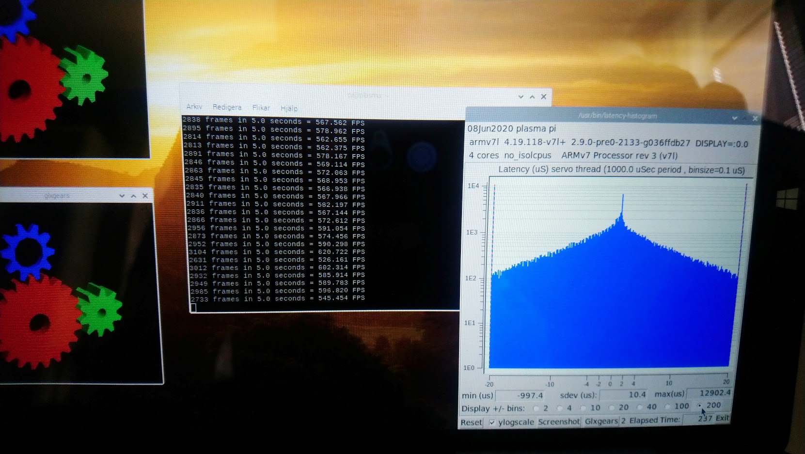

Also I now and then get following error message:
hm2/hm2_7i96.0: error finishing read! iter=125546 (this no varies)
Is the RPi getting exhausted ?

That is getting to be interesting:
Error finishing read is a latency issue, a very bad one as it is loosing connection to Mesa board.
The other issues i just noticed in the ini file, why is there a max_error? And why is there a value set for FF2? And why are the values for ferror and min_ferror so low ?
So, delete the max_error line, set the FF2 to 0, ferror to 1 and min_ferror to 0.1.
For all axis/joints.

08 Jun 2020 07:01 #170630
by tecno
Replied by tecno on topic Can not get step settings that works OK
- Posts: 22036
- Thank you received: 7504
08 Jun 2020 07:25 #170631
Replied by tommylight on topic Can not get step settings that works OK
FF2=0
not 1
And that is very bad latency.
Check the RPI4 topic, might have some info on how to get the latency down.
not 1
