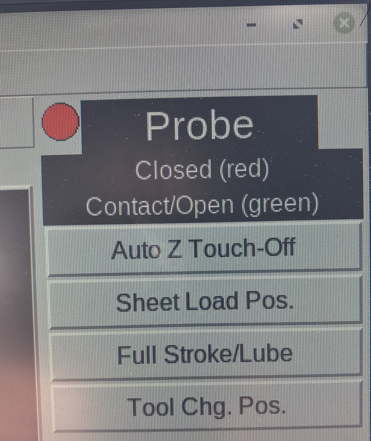

So I'm adding buttons and subroutines to my Axis panel to control auto touch-off and some other stuff. I came across this old post which encouraged me to spruce my panel up a bit.
Fancy Buttons and Labels
My panel is like so.
My question is is there a way to change the background color of an LED widget?

.. or is there a way to change the background color of the "vbox" that contains all my buttons and LED?

Not that i know of, but i know very little about it. I can make VCP panels for pretty much everything i need, but never bothered with colours, maybe it is time to do something about it.
