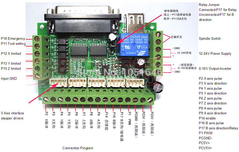

I use an 7i96 with a Chinese paralel BOB on connector 3. I use some special firmware so that I can use the BOB for a pwm signal for my spindle. This all works great.

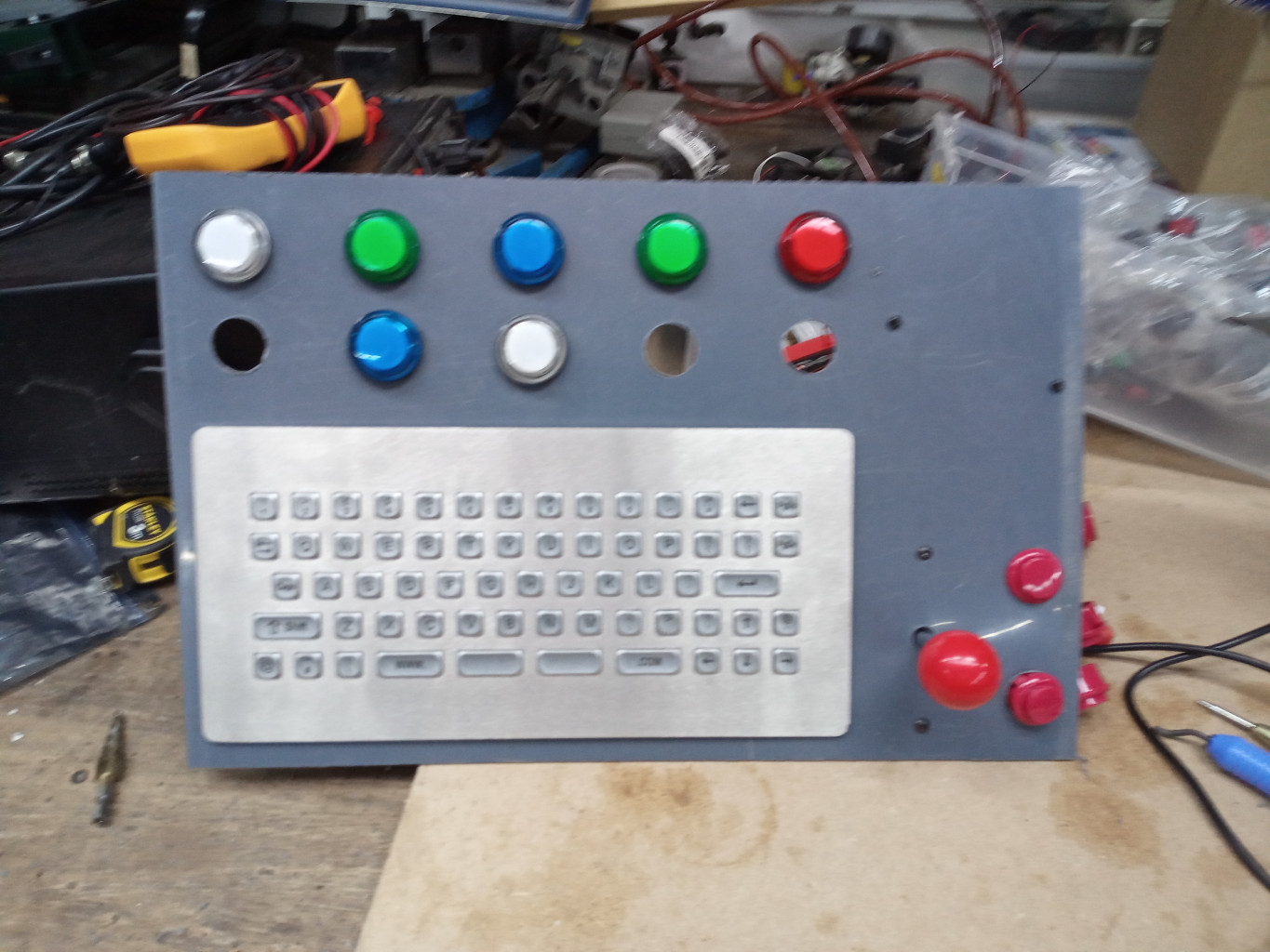

Lately I added a lot of switches through a Chinese USB Arcade controller. That controller takes care of all the inputs and using some of Ask Jerry's video I got it all working.
But now I try to use the not used in and outputs of the BOB, but I just can not seem to make it work. The inputs show up in a halcmd show pins, but I just can not make an output working. How do I control one of the outputs on the BOB in my hal file?

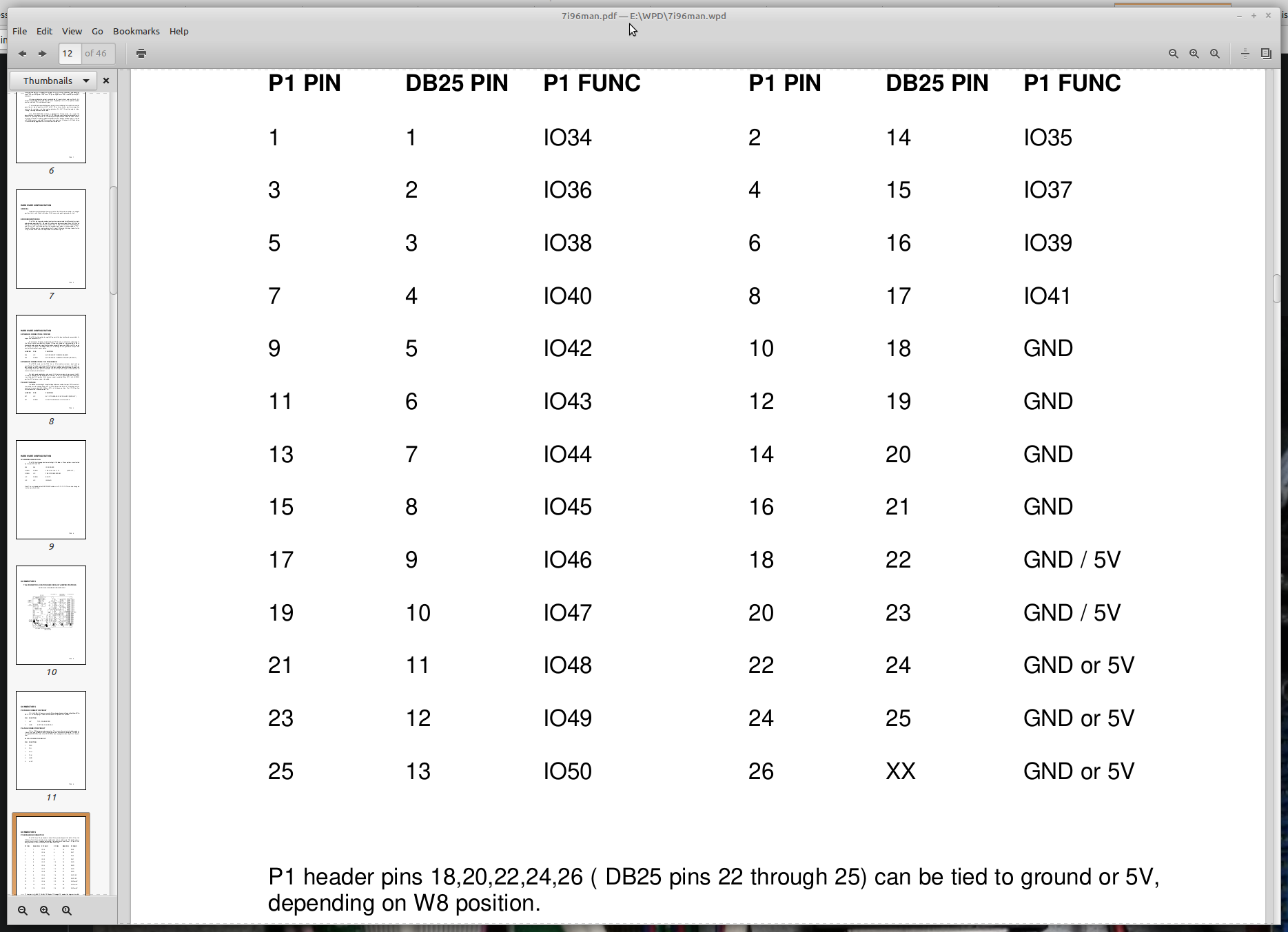

29 Dec 2020 10:18 #193434 by tommylight
Replied by tommylight on topic Mesa 7i96 with paralel BOB
IO 34 is the first on the header as can be seen from the 7i96 manual:
As I said I am no wizard and need help.
What do I need to do to get the P2 pin (see image) high so I can attach an Led or other load to it? Most Led's will be signaling a gmoccapy/halui state. So the outputs on screen need to be coupled to the Led's controlled by the Bob gpio pins.
According to the 7i96 they indeed start at gpio.034. (Why does the range of output pins start at 030, where are the 4 missing outputs?)
If you could please make a simple example for the mist control maybe? So when I connect the Mist-on in postgui.hal to a button on the joystick card I would like to be able to see the state change through a Led in the button controlled by the Bob.

30 Dec 2020 04:45 #193508 by tommylight
Pin2 should be IO36
