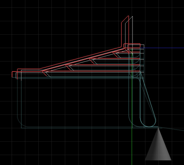

So if your G54 offsets are negative the plot is wrong?
By the wat what is wrong with plot? tool offset on wrong side?

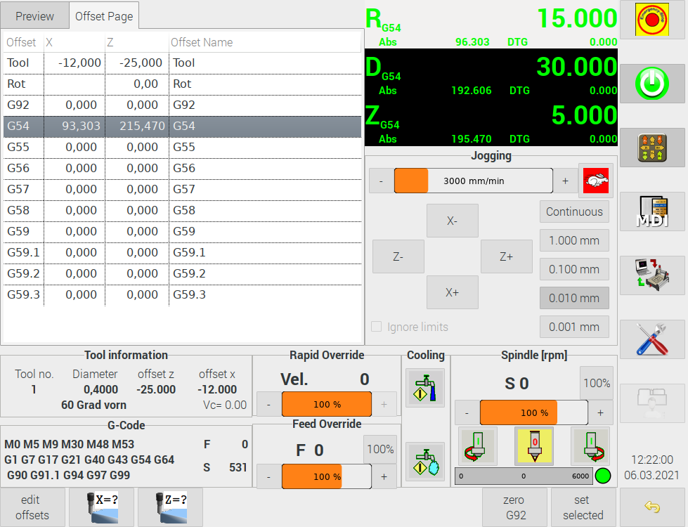

This is just a minor problem, it is caused due to calculation errors in some part of the code, most probably some rounding errors or unprecise calculation. Sqr(2)*sqr(2) will not give 2 but something similar
Try to set your offsets to exact numbers, like 10 / 10 / 10
The grafical deviations should be gone. I know you can't do that in real work, but just test.
Norbert
Norbert

It works good, but It is not possible in real world, as you wrote.
Is possible use preview from Axis to Gmoccapy? Or use old gremlin? Or .....?
Has gremlin always had this problem?
Replied by zz912 on topic Wrong preview

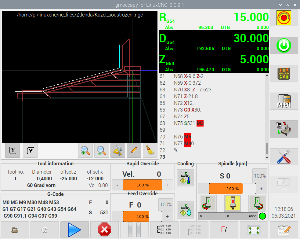

Thank you for your response and I apologize for bothering you with the design issue alone.
When do you expect MINOS to be released? Just indicative. Half a year, two years?
Will it also be applicable for LCNC 2.8, or only for LCNC 2.9?
Gmoccapy is great, but this bug doesn't make it possible to predict what the machine will do, especially when there are many tracks.

By the way, I have never seen it as much as in your preview. If you like, I can llok over your config. In that case just post your config folder and the File you loaded. Please note also the offsets (difference between relative and absolut numbers from the DRO's, so I am able to reproduce that.
This way we can at least exclude, that it is related to the OS or window manager, by the way what Linux and window manager do you use?
Norbert
I just wanted to make clear, that I am not going to fix this.

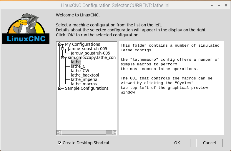

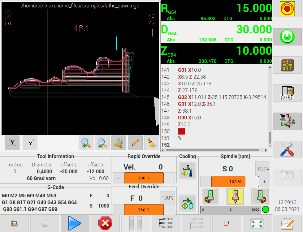

For testing can be used normal simulation LCNC2.8 LIVE CD
G54 must be non integer:
bug:
Configuration files are not needed, but if necessary I attach:
*.ngc files for testing:
Same problem I have with desktop computer and with RPI4.
Can I ask someone to try it too?
Whether we know if there is a bug in my hardware or if it is the standard behavior of LCNC 2.8 gmoccapy.
bug:
