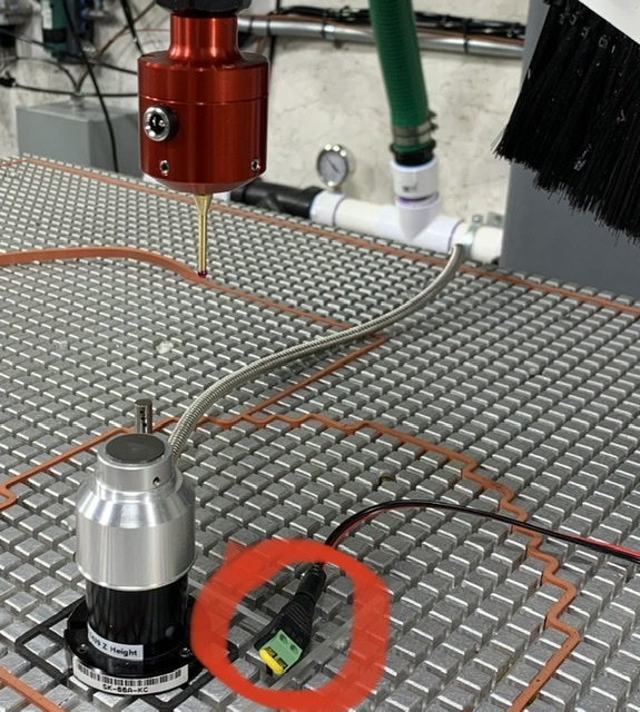

Have a look near the end of the similar thread previously linked to where I show a custom HAL component that latches the state of up to 8 probe inputs when the machine is turned on (F2) and then drives the motion.probe-in pin whenever is sees a _change_ in any input.
Replied by andypugh on topic Second Probe
Any suggestions?

Replied by hoffb77 on topic Second Probe
