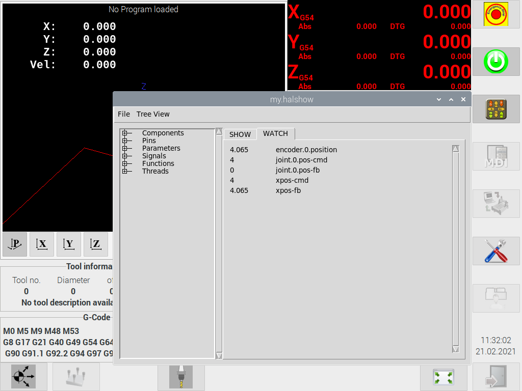

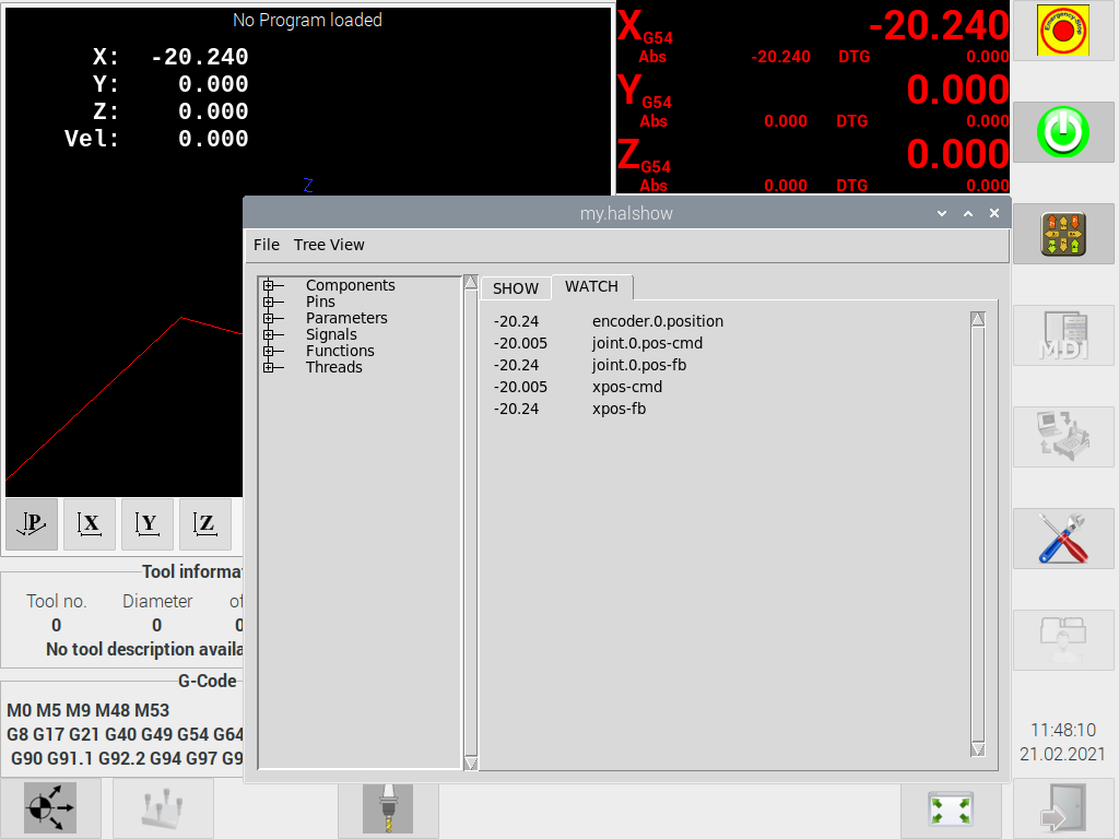

So… there were some re-declarations of things like debounce.0. but I sorted those out.
I attached an updated version of the HAL.
Went and tested but saw the same result.
But I noticed that you put in net xpos-fp => joint.0.motor-pos-fb # feedback to joint data e.g. xpos–fp. Was that on purpose or should it had been xpos-fb?
Just for kicks i changed it to xpos-fb with much greater success
It doesn’t seem to be correcting anything at this point but I’m assuming that comes down to tuning.
No that was a mistake. But i wonder. Your other data called
pos-cmd and so on. I thing that the Point. We have to clear this Syntax. It seems now your Feedback is working. Can you move your axis in jog? Where are your command data written?

I see you have the position command directly to stepgen. To engage feedback the position command has to go via the pid component so it can adjust for the position deviation.

@ Chris You’re back early
Regarding the syntax i’m pretty much up for anything you may recommend.
Yes. I’m able to move the axis and as long as my ferror is high enough i don’t get a joint following error.
(which is obvious even to me)
“Where are your command data written?” I’m sorry but i don’t understand the question?
(well having read Hakans post i think i do)
If i understand this right ??? commands are going to
net xpos-cmd joint.0.motor-pos-cmd => stepgen.0.position-cmd
@ Hakan
That would explain it and it makes sense.
BTW: I may not be right and have you mixed up with someone else but if i’m right i’m a fan of your videos.
Just want to take a second here to say thank you guys. This makes a world of difference to me.
@ Hakan

Here is my z-axis, it uses stepper motor and encoder for feedback. It uses hm2-components instead of the basic encoder and stepgen, but the principle is the same. Check how the pid component comes in, I think it can be the same obviously with the right naming.
# AXIS Z
setp pid.z.Pgain [JOINT_2]P
setp pid.z.Igain [JOINT_2]I
setp pid.z.Dgain [JOINT_2]D
setp pid.z.bias [JOINT_2]BIAS
setp pid.z.FF0 [JOINT_2]FF0
setp pid.z.FF1 [JOINT_2]FF1
setp pid.z.FF2 [JOINT_2]FF2
setp pid.z.deadband [JOINT_2]DEADBAND
setp pid.z.maxoutput [JOINT_2]MAX_OUTPUT
setp pid.z.error-previous-target true
setp pid.z.maxerror 0.0
net z-index-enable <=> pid.z.index-enable
net z-enable => pid.z.enable
net z-pos-cmd => pid.z.command
net z-vel-cmd => pid.z.command-deriv
net z-pos-fb => pid.z.feedback
net z-output => pid.z.output
# Step Gen signals/setup
setp hm2_7i76e.0.stepgen.02.dirsetup [JOINT_2]DIRSETUP
setp hm2_7i76e.0.stepgen.02.dirhold [JOINT_2]DIRHOLD
setp hm2_7i76e.0.stepgen.02.steplen [JOINT_2]STEPLEN
setp hm2_7i76e.0.stepgen.02.stepspace [JOINT_2]STEPSPACE
setp hm2_7i76e.0.stepgen.02.position-scale [JOINT_2]STEP_SCALE
setp hm2_7i76e.0.stepgen.02.step_type 0
setp hm2_7i76e.0.stepgen.02.control-type 1
setp hm2_7i76e.0.stepgen.02.maxaccel [JOINT_2]STEPGEN_MAXACCEL
setp hm2_7i76e.0.stepgen.02.maxvel [JOINT_2]STEPGEN_MAXVEL
# --- Z axis encoder feedback signals/setup
setp hm2_7i76e.0.encoder.02.counter-mode 0
setp hm2_7i76e.0.encoder.02.filter 1
setp hm2_7i76e.0.encoder.02.index-invert 0
setp hm2_7i76e.0.encoder.02.index-mask 0
setp hm2_7i76e.0.encoder.02.index-mask-invert 0
setp hm2_7i76e.0.encoder.02.scale 1000
# ---closedloop stepper signals---
net z-pos-cmd <= joint.2.motor-pos-cmd
net z-vel-cmd <= joint.2.vel-cmd
net z-output <= hm2_7i76e.0.stepgen.02.velocity-cmd
net z-pos-fb <= hm2_7i76e.0.encoder.02.position
net z-pos-fb => joint.2.motor-pos-fb
net z-enable <= joint.2.amp-enable-out
net z-enable => hm2_7i76e.0.stepgen.02.enable
net z-vel-fb <= hm2_7i76e.0.encoder.02.velocity
net z-vel-fb => pid.z.feedback-deriv

Tried this out and that brings us/me back to the original problem.

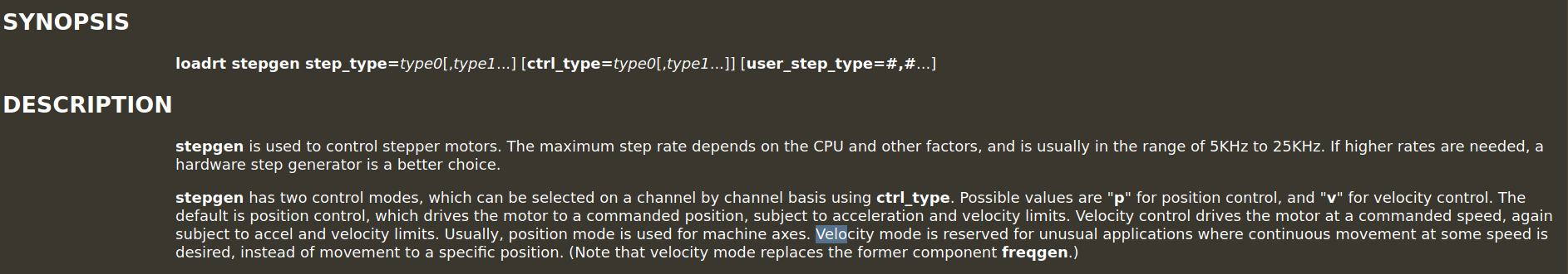

I’m running position mode not velocity. And as stated in the first two replies and based on your configuration apparently i need to be in velocity mode. I have no objection to running velocity mode what so ever but i can’t figure out how to do that either.
I spent yesterday reading countless configurations and forum posts as well as the stepconf component description but none of it put me in a position to make the changes to the configuration. Well i made tons of changes but none of it worked. I’m clearly missing something here… Hence my cry for help yesterday.
Well… I’m a fan all the same. They feel like real life not the polished version.

According to this:
it seems you would set the mode to velocity here:
Maybe try:
[edit]
For more information including some examples:
linuxcnc.org/docs/html/hal/rtcomps.html
loadrt stepgen step_type=0,0,0Maybe try:
loadrt stepgen step_type=0,0,0 ctrl_type=v,v,v[edit]

what do you want to do in velocity mode? Usually axes are in position mode and spindle in velocity mode.

You can also work in position mode. I tried both and found the velocity mode worked better.
The other change needed is to set FF0=1 instead of FF1=1 for position mode if I remember right.
