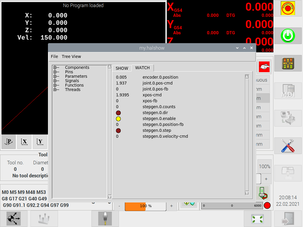

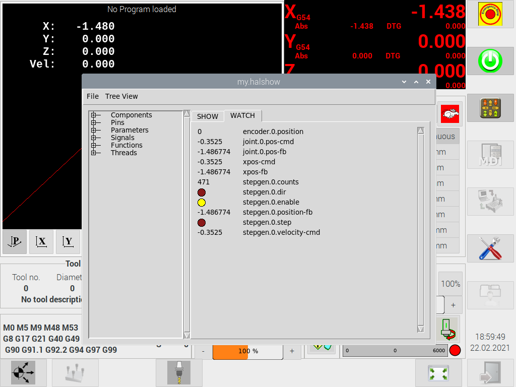

22 Feb 2021 18:57 - 22 Feb 2021 19:10 #199753
by yagias
Replied by yagias on topic Need a bit of help with a Raspberry PI 4 GPIO Glass scales control loop
ok. currently i added the three lines starting from line 70:
And it now looks like this.
Result:
Now nothing moves
Haven't begun aligning to hakans example yet.
# JOINT_0
setp stepgen.0.position-scale [JOINT_0]SCALE
setp stepgen.0.steplen 1
setp stepgen.0.stepspace 0
setp stepgen.0.dirhold 15200 #If motor not turn increase time
setp stepgen.0.dirsetup 15200
setp stepgen.0.maxaccel [JOINT_0]STEPGEN_MAXACCEL
#net xpos-cmd joint.0.motor-pos-cmd => stepgen.0.velocity-cmd
net x-output <= stepgen.0.velocity-cmd # velocity to PID
net xpos-cmd <= joint.0.motor-pos-cmd # new calculatet back to xpos-cmd
Result:
Now nothing moves

well done.
this line is double
net xpos-fb => joint.0.motor-pos-fb # feedback to joint data
if you switch to open loop you schould comment this line to
Next step check in open loop your movement. Maybe we can trust the encoder data and travel 200mm end of your table.
Compare encoder position with stepgen.0.position-fb postion.
Adjust SCALE = -320 in ini File to min difference.
last step switch encoder on and cross finger
this line is double
