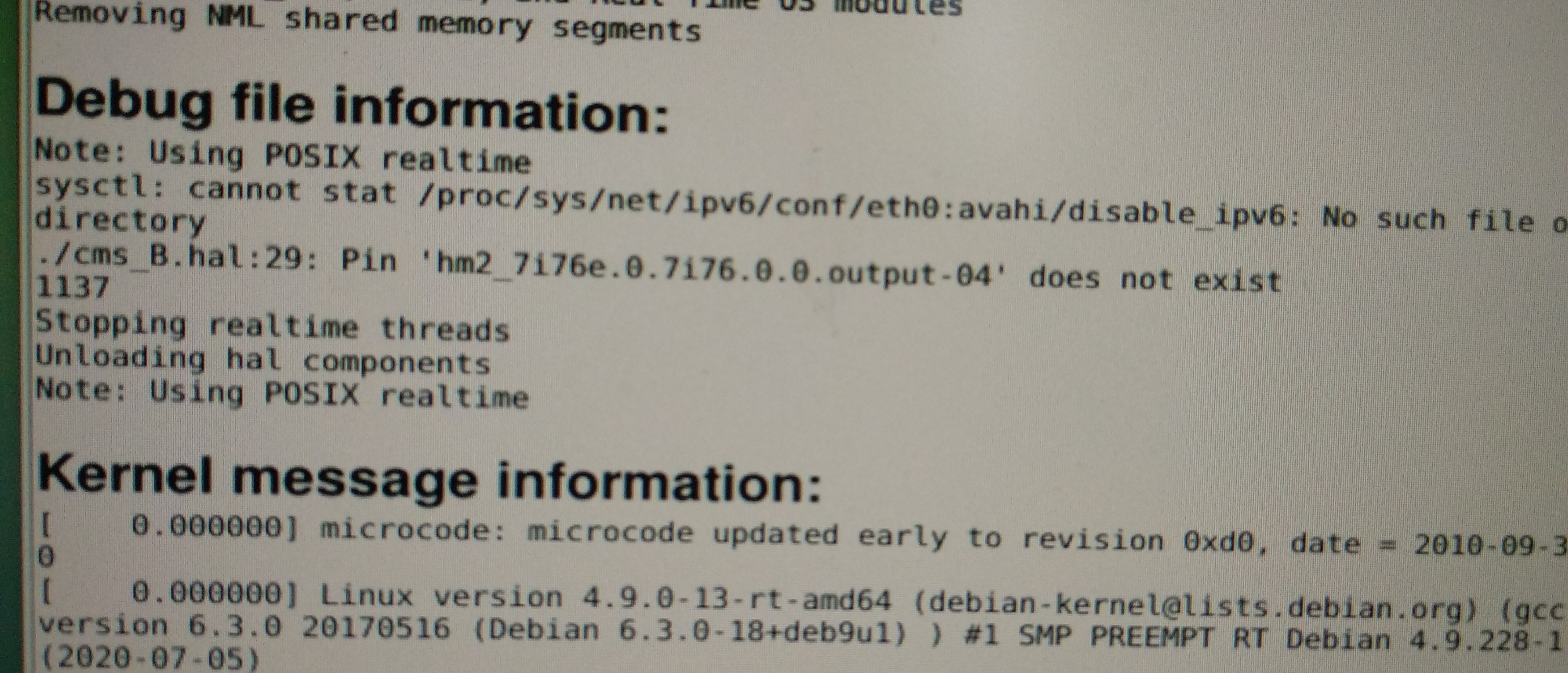

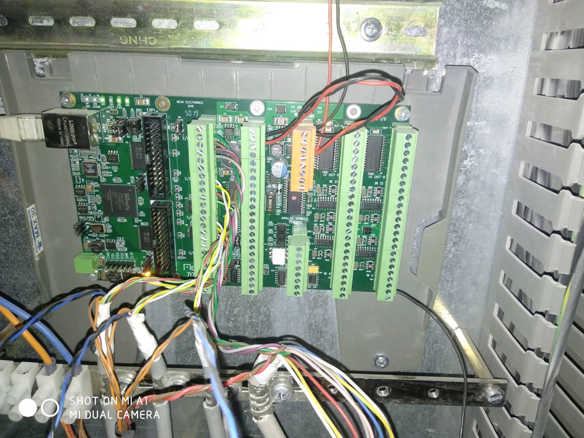

Hello I have two boards of 7i76e
with the one and the same configuration I can trigger an output
with the other one I have this error
- Yannis
- Posts: 297
- Thank you received: 4
18 Mar 2021 12:49 #202735
by Yannis
Replied by Yannis on topic 7i76e input output config
Debug
- Posts: 18111
- Thank you received: 5330
18 Mar 2021 15:05 #202745
Replied by PCW on topic 7i76e input output config
If you get that error it likely means:
1. You have no field or VIN power (VFIELD >+ 5V VIN >8V)
2. W8 in right hand position
3. 7I76E with damaged I/O section
The following user(s) said Thank You: Yannis
