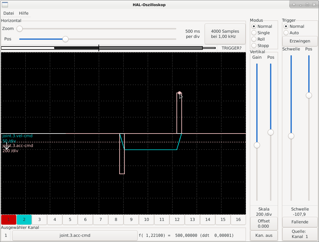

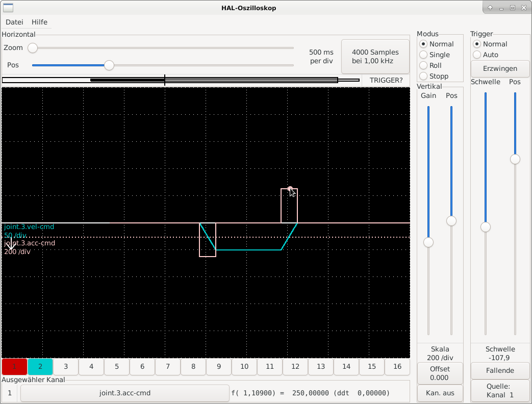

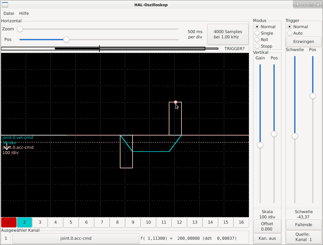

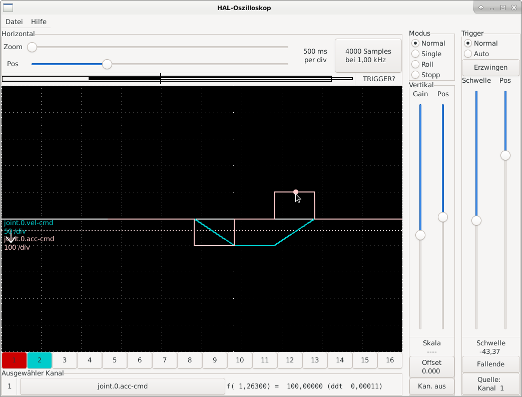

the machine is configured with MAX_ACCELERATION = 500mm/s².
I move with G38.2 F3000 to the probe switch.
At F3000 (=50mm/s) expected deceleration distance is 2.5 mm (V²/(2*a)).
But the braking distance is about 5.1 mm.
This corresponds to a deceleration of 250mm/s².
So the machine brakes with half the deceleration. (250 mm/s² instead of 500 mm/s²)
What is the reason for this?
LinuxCNC is 2.9 master

- roland
- Posts: 140
- Thank you received: 64
26 May 2021 10:18 #210355
by roland
Replied by roland on topic Deceleration distance too long
I agree with you
ini attached.
It's about the Z axis
ini attached.

26 May 2021 12:44 #210367
by roland

26 May 2021 12:50 #210368
by BigJohnT
Replied by BigJohnT on topic Deceleration distance too long
X and Y max acceleration is 200 so if this is a coordinated move including either one of those axes then it makes sense, no axis will exceed it's settings. If it is a rotary IIRC that can affect the total acceleration.

- roland
- Posts: 140
26 May 2021 13:04 #210371
by roland
- Posts: 19904
26 May 2021 14:40 #210386
Replied by andypugh on topic Deceleration distance too long
Is any acceleration allocated to "external offsets"?
- Posts: 18118
- Thank you received: 5336
26 May 2021 14:43 #210387
Replied by PCW on topic Deceleration distance too long
I get the same response:
MDI at 1/2 programmed accel limits
GCode (G0 G1 at least) and jogging at full speed
Not setup to try G38
2.8.1 and 2.9 are identical in this respect
- Posts: 19904
26 May 2021 14:47 #210389
What happens with feed-override maxed out? I am wondering if it is that overhead.
- Posts: 18118
26 May 2021 15:04 #210390
The acceleration seems to be independent of the feed rate
I suspect the cause of the acceleration difference is that unplanned
moves are treated differently by the TP
Doesn't jogging use an independent "planner"?
