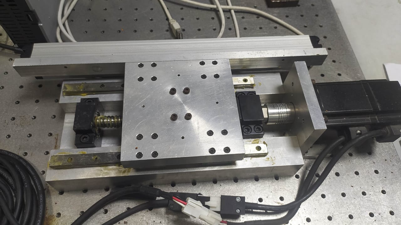

Hello Forum,
So far I have good progress in PID Tuning. I tuned my linear actuator using Kp. FF1, and FF2 and reduced the following error within 40 micron in 50 mm travel at speed of (G01 X50 F16).
What I observe is when I change the speed or travel length I get more error than 40 micro-meter and need to adjust/retune the parameter. So I am confused what parameter should I tune?
My requirement is
100 mm travel length, Max Velocity 20 mm/sec, Following Error within 10 micro-meter, 0.1 micron overshoot, Vertical Load 5 Kg, Horizontal Load 5Kg.
So, I guess I should tune on at full-load/worst-condition G01 X100 F20 parameter and with horizontal and vertical load. Is the PID parameter will work and error will be within the limit if I run the command under the limit? Please guide me on the actual tuning practices.

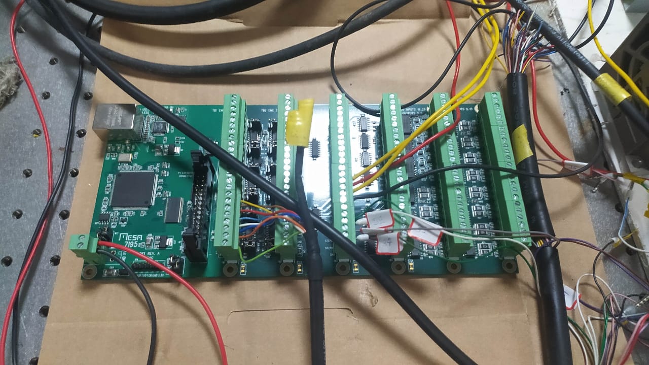

Its hard to guess what the tuning issue are without a plot of following error vs velocity
I would suggest adding a USB--> Ethernet or USB -->WIFI dongle to your system so it has network connectivity.

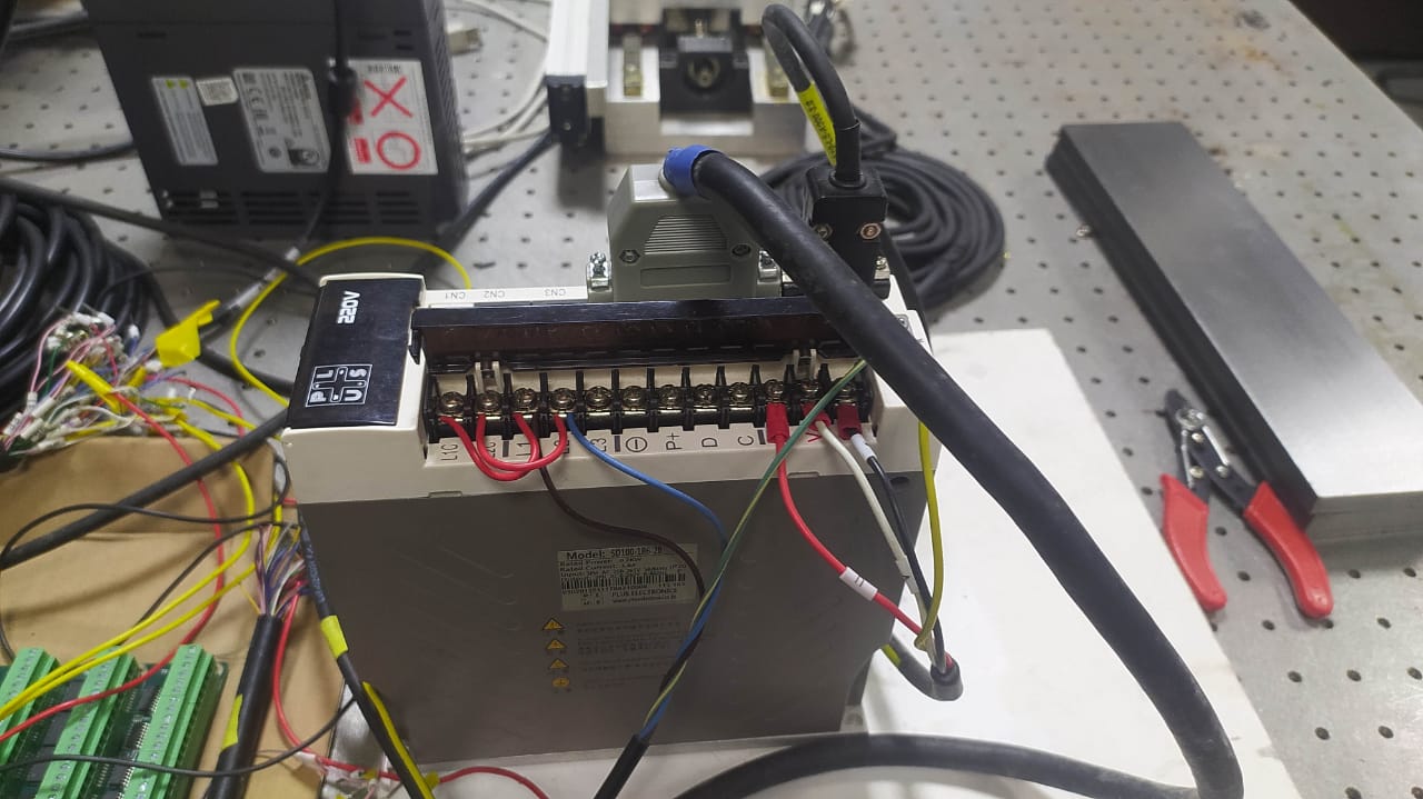

What kind of motor drives are you using?
- suraj9735
- Posts: 83
08 Jul 2021 08:48 #214013
by suraj9735
Replied by suraj9735 on topic PID Tuning
I am developing submicron precision ball screw linear stage. And using advanced AC Servo Drive and 200 W AC Servo Motor of Plus Electronics Brand (manual attached). Does PID tuning method depend on drive type I am using? What's the minimum possible following error and overshoot limit I can achieve with my setup. Do I need to use Ki, Kd to improve the result?
09 Jul 2021 11:47 #214081
Replied by andypugh on topic PID Tuning
There is no inherent accuracy limit to PID. Any limitations are in the hardware and feedback.
If you want a precision of X um then you need to have several encoder counts per x of movement.
Then you should be able to make it work.
I would certainly expect to need some I-gain to pull the last bit of steady-state error out.
