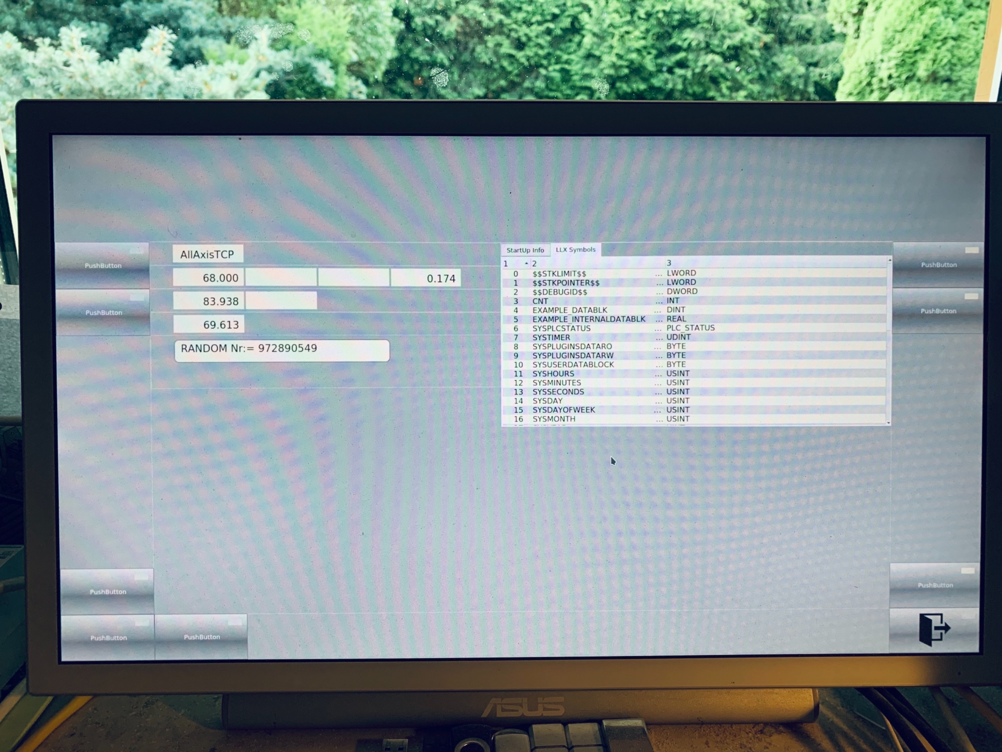

i started with the position-logger using nml and ported it to qtcreator c/c++. No Py.
Now there is suppose to be a .dtg value for each axis.
I can not find the tuple for it in the emc_stat. And so on. No docu on that.
std::get<0> (emcSTATUS->.......... .dtg);
The docu‘s in Py I have seen already.
