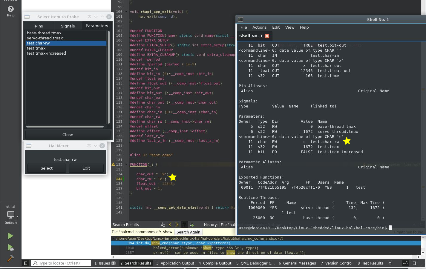

02 Jul 2021 04:00 #213479
by Grotius
Replied by Grotius on topic halpin of type "char".
I think i really need a halpin of type "char".
In a upcoming project a .ngc file has to be loaded from the component.
I need to be able to pass a "char array" to a component input pin.
Passing a string at the component init stage is ok, but not usable at runtime.
Do i need to add this "char" pin to the source code?

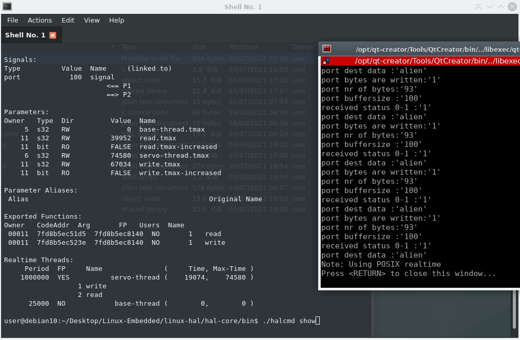

03 Jul 2021 21:17 - 03 Jul 2021 21:22 #213590
by Grotius
Hi Rod,
You where right !.
I managed to get the port function working in a example component "port.so"
It sends a string (char array) from point a to point b trough hal.
This example uses one component.
Normally it would serve between at least 2 components.
It is indeed badly documented.
The buffer is allocated by a setsignal command, this is quite unusual.
For the rest it works out of the box ! Many thanks for your advice !
You where right !.
