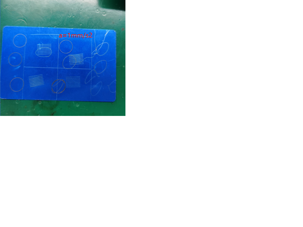

May it caused by a time sequence problem, a few CNC senior Engineer analysizied that it caused by Y axis command period long 20ms than than x axis command period.
- Thank you received: 4652
19 Oct 2021 00:06 #223512
Replied by andypugh on topic it is too fast to use F200 with G2?
So, your max acceleration in the INI is 600 mm/s2 and you need 2000 mm/s2. So your machine can not make that radius at that speed. (The machine units are mm)the result of the calculation v^2/R is 2m/s^2, the max acceleration in my INI is 600,

19 Oct 2021 04:00 #223517
by curran209
Replied by curran209 on topic it is too fast to use F200 with G2?
when i set max acceleration to more smaller, it's to gooder. a =1mm/s2, the effect was almost not too far, but the speed only can to be 120mm/min,it's too slow.

19 Oct 2021 08:47 #223535
Physics dictates the acceleration required to draw a circle of given size and speed.
Your mechanical design dictates the maximum possible acceleration.
If your machine can not actually accelerate at the required rate then it can't draw the circle.
You need to make your machine lighter and more powerful.
This is entirely a problem with your mechanical design and there is nothing that LinuxCNC can do about it.

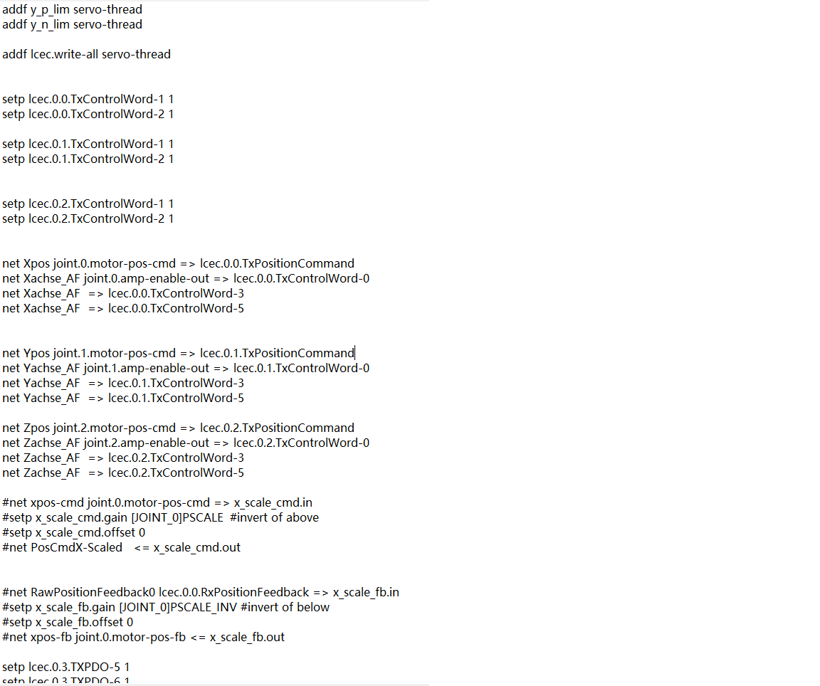

20 Oct 2021 01:48 #223613
by curran209
Another CNC control software can use this machine draw circle with setting F6000 and r =5mm.
Does these hal and ini file image enough to analysis it?

20 Oct 2021 03:27 #223625
Replied by PCW on topic it is too fast to use F200 with G2?
Where does the joint feedback data come from?
That is, what drives joint.n.motor-pos-fb
or is this open loop
Is there some reason you cannot post the entire hal and ini files?
- curran209
- Posts: 56
20 Oct 2021 09:18 #223643
by curran209
please review it.
