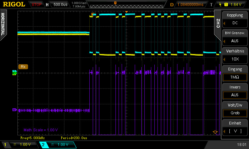

I'm connecting to a Parker AC10 VFD via USB/Modbus from linuxcnc 2.8.2.
But the connection is unreliable. There are sucessfull commands but a lot of errors too:
CRC
Connection timed out: select
Request for slave 128 ignored (not 1)
Looks like a physical i.e. wiring problem, but there is a nicely terminated twisted pair wiring between VFD and USBtoRS485.
Even more the same wiring worked well with the Parkers antecessor a huangyang VFD.
Any ideas?
CRC
Any ideas?

Try using an RS485 adapter with A/B and GND connection instead of those simple USB with A/B only. I had similar issues before, if I remember correctly.

Meanwhile I could solve the case by using another USB2RS485 adaptor..
The old one showed some weird behavior on the scope. With only 250 mV dU between A+ and B- it was inside standard but obviously outside the parker AC10s expectations. .
The new one (with GND connection by the way) showed of better
