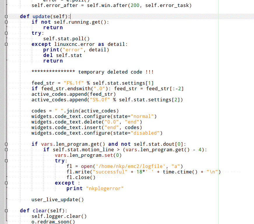

Thank you for your effort. I have implemented the changes and tried them out. Everything works fine as long as no macro calls are in game.Unfortunately, since I use the remap command with macro call for my manual tool change, the current solution does not work:
If the required tool (Tool 9) is not in the spindle at cycle start, only the file name of the tool change macro with timestamp appears in the log file. The success is not logged.
If the tool (tool 9) is already in the spindle, the start is logged with the actual file name. At the first tool change (tool 11) success is logged and then nothing more.

need your file remap

instead of the file currently loaded into task(s.file),
we must take the file loaded only initially (loaded_file)
so
try:
count = 0
for line in open(loaded_file).xreadlines(): count += 1
vars.len_program.set(count)
fl = open('/home/nkp/emc2/logfile', "a")
lnf = len(os.path.basename(loaded_file))
fl.write(os.path.basename(loaded_file) + (28-lnf)*' ' + time.ctime() + "\n")
fl.close()
except :
print "nkplogerror"
ps

Gave it a try, the result is following:
Than there is nothing more logged. Attached you can find my remap code (i can translate to english if neccesary)

do not read line number while subroutine
o<messen> sub
m64p0
#1700=44 (Wechsel X Position)
#1701=0 (Wechsel Y Position)
m65p0
o<messen> endsub
M2
def update(self):
if vars.len_program.get() and not self.stat.dout[0]:
if self.stat.motion_line > (vars.len_program.get() - 4):
vars.len_program.set(0)
try:
fl.write("successful" + 18*' ' + time.ctime() + "\n")
fl.close()
except :
print "nkplogerror"
it work for me with your gcode
o<messen> sub
m64p0
m65p0
o<messen> endsub
M2
def update(self):
try:
fl.close()
except :
print "nkplogerror"

Very creative approach. I put the M64Pxx on an output that I don't use. Seems to work fine so far. Thanks a lot!
I left "user_live_update() " in the code:
Is this correct? Dangerous copy and paste...
Best regards
Jan
def update(self):
if not self.running.get():
return
try:
self.stat.poll()
except linuxcnc.error, detail:
print "error", detail
del self.stat
return
if ( (self.stat.motion_mode == linuxcnc.TRAJ_MODE_COORD)
and (self.stat.task_mode == linuxcnc.MODE_MANUAL)
set_motion_teleop(1)
if ( (self.stat.motion_mode == linuxcnc.TRAJ_MODE_TELEOP)
and not vars.teleop_mode.get() ):
vars.teleop_mode.set(1)
# CHANGES FOR LOGFILE
if vars.len_program.get() and not self.stat.dout[10]:
try:
fl = open('/home/cnc/linuxcnc/logfile', "a")
fl.close()
except :
print "nkplogerror"
user_live_update()
# CHANGES FOR LOGFILEIs this correct? Dangerous copy and paste...
Best regards
Jan
