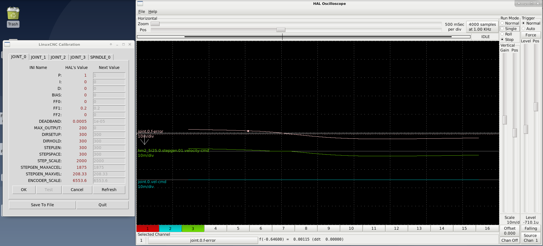

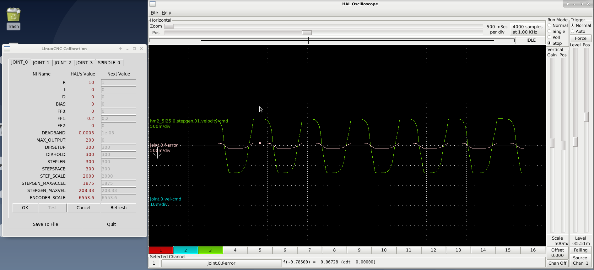

- Faggan
- Posts: 28
14 Jun 2022 06:25 #245108
by Faggan
Replied by Faggan on topic Stepper controlled servos doesnt move with Encoder feedback configured
Changing the parameters you mentioned PCW worked. Thank you.
I now find myself with other issues related to PID tuning (I think)
All guides I have seen (if I understood them correctly) tells you to start to increase P until there is vibration on the axis and then back off.
My issue is that from extremely low P values I have oscillation on the axis after a short move. During a move the oscillation is very small.
I don't know how to get around this. If I try to use D gain to get rid of the "idle" oscillation I need to put so much D value on there that the axis now stutters when I do a commanded move.
Increasing P gain only results in a higher frequency oscillation with higher amplitude. At P1 the amplitude is about 0,003mm. At P10 its around 0,06mm.
Is there any way of dampening the "idle" oscillation?
