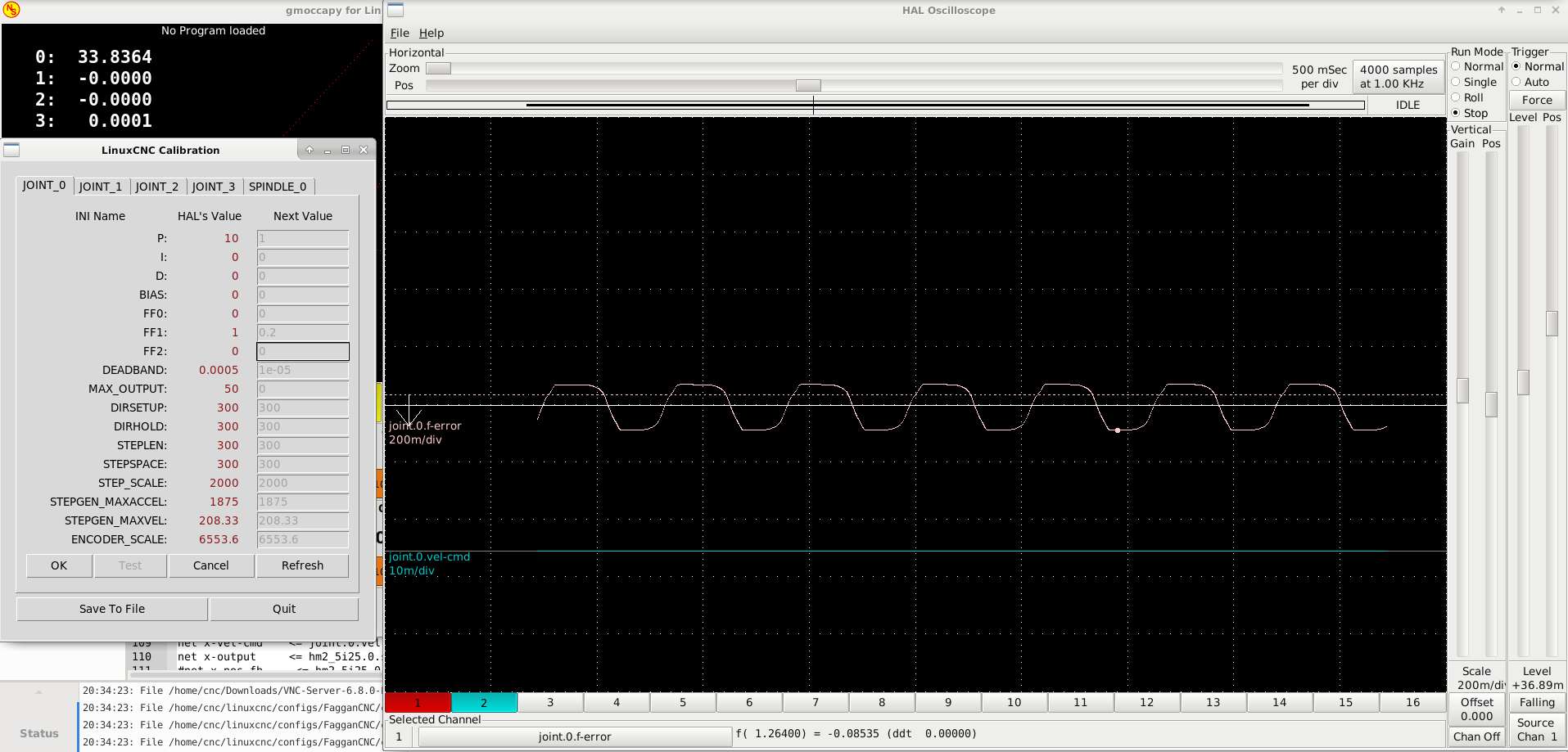

The encoders are 1048576 pulses per revolution default. (0.0003 degree resolution)
I have scaled them down to 65536 pulses per revolution. That gives me 0,000153mm resolution with 10mm per rev ball screws.

Replied by PCW on topic Stepper controlled servos doesnt move with Encoder feedback configured
If the encoder and step scale are commensurate, FF1 must be 1.000
Plotting the encoder position might help as would posting the current hal/ini files
To get that kind of response I would think there must be a relatively large delay
from step command to encoder feedback, so this looks more and more
like a drive setup issue.
Are there any filters setup in the drives commanded position path?
Are there any velocity or acceleration constraints in the drive
lower than the stepgen constraints?

@PCW
You are correct. I had assumed that my servos and drives wouldn't need tuning because of a auto tune function they have. After a lot of reading manuals it turns out that the function only applies in speeds of 1000 rpm and higher (10 000mm/min for me). After some rough tuning of the X drive I have lowered the oscillation by a factor of 7. Looks like it will come into spec once I give it a bit more tuning.
Thank you so much for helping!
