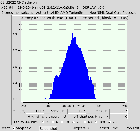

Hi, I'm new to Linuxcnc, but have made cnc machines with other software/boards.
I've recently done a cnc conversion on a small manual lathe using open loop stepper motors and a mesa 7i76E board, and the configuration has been really very slick with pnconf.
However, the stepper movements are rather rough/scratchy and slightly noisy. The movements are very smooth with pulses from a signal generator, but looking at the pulse output from the mesa board on a 'scope there appears to be quite a lot of jitter in the output causing the rough movement.
I'm using a dedicated PC, which is an HP Proliant microserver.
I've got the base thread latency below 50usec, after disabling stuff in the bios, and I am using a 1ms servo thread.
The PC has a Broadcom BCM5723 network card.
uname -a reports:
Linux cnclathe 4.19.0-17-rt-amd64 #1 SMP PREEMPT RT Debian 4.19.194-2 (2021-06-21) x86_64 GNU/Linux
If I reduce the servo thread to 500usec, the movements are much smoother, but I get some realtime delay errors, I suppose not surprisingly. A servo thread of 2ms seemed to make it worse.
The network card seems to use IRQ coalescing of 20usec, according to ethtool, and although it isn't an Intel card I tried setting it to zero. In fact it wouldn't support less than 1, and 1 made no difference.
If I ping the mesa board I get times of:
min 0.16ms, avg 0.201ms, max 0.34ms, mdev 0.026ms. I'm not sure how good/bad those figures are.
As I understand it, dpll is enabled on the mesa board by default, but I tried toggling the setting in halcmd to be sure.
I'm not sure what to try now, so any help would be very appreciated, please
Many thanks
Phil
Histogram attached

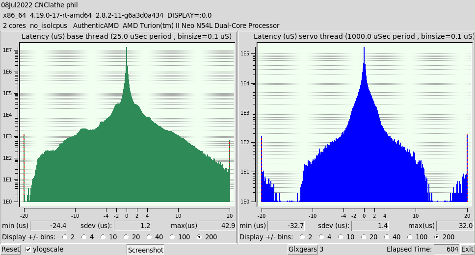

Try an MDI move or run some short gcode, if it moves smooth, change the keyboard or use this
forum.linuxcnc.org/38-general-linuxcnc-q...elocity-fluctuations
If it is still rough, set the step time and step space to at least 5000 in hal or ini
Also, use this for latency testing:On your picture there are excursions on both sides and both screens that can not be seen, notice the striped lines.
latency-histogram --nobase --sbinsize 1000 --showPlease Log in or Create an account to join the conversation.

The hal/ini files look OK except I would use a larger DPLL pre-sample time, perhaps 100 usec
plotting the same variables I plotted will help diagnose the issue:

@PCW Brilliant! Big thanks :-)That's got me going with halscope, and the change to the DPLL pre-sample time has made the movements perfectly smooth
I've had a fail with a screen dump, so I've attached halscope data files with before and after traces, I hope that is ok. If not I'll try harder. Anyway, hopefully you will see the hideous following error initially. Significantly reduced after the change. There is a pretty large DPLL error, which I assume means that I need to try for a bit better latency.
I've repeated my histogram, with the parameters as suggested by @tommylight (many thanks) and these reveal more latency than gets shown with no parameters - I'll attach. Also for completeness, @tommylight, the moves were still rough with MDI/gcode moves, and my step pulse times were as you suggested.
