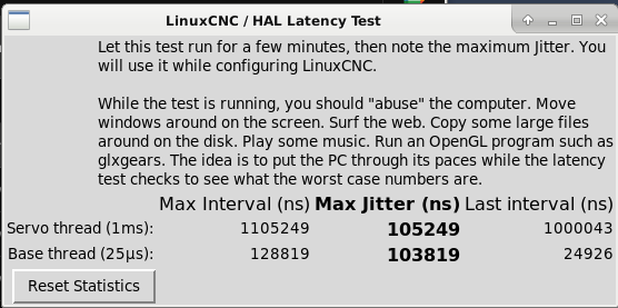

Need some assistance understanding my Latency Test result

1. I would test with just a servo thread since with external hardware,
the base thread will not be used. (use the --nobase latency-histogram option)
2. You should enable all cores
3. I still suspect there is some power saving option enabled (whether or not
it can be disabled in the BIOS is an open question however)

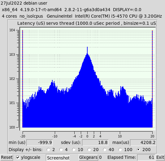

I noticed the servo thread histograms look quite different from each other. The only difference is the nobase one I had a browser open with gmail where I did not with the other one.

No I was trying to ask if you were trying to run this in a VM because your latency results are that bad, and that your results are worse than I see in a VM. But A VM will never have good enough latency to run a machine. (No you should not try it. VMs are only good for simulations.)
Like Peter said there must be some power saving feature (such as C states) or some other latency destroying feature enabled in your bios that needs to be turned off.

If he's running preempt-rt, shouldn't it say "Note: Using POSIX realtime"? Mine does:Also from the terminal while histogram was running:
"msg=can't use non-numeric floating-point value as operand of "*" (variance=-2116125128)"
$ latency-histogram --nobase
$ uname -a
Linux lathe 5.10.0-11-rt-amd64 #1 SMP PREEMPT_RT Debian 5.10.92-1 (2022-01-18) x86_64 GNU/Linux

So I ran latency-histogram --nobase again to see if I get that message. My message says "Note: Using POSIX non-realtime".
Good catch! So what do I need to do to install a realtime kernel? Will this mess up the Windows OS that is loaded on it? I don't want to mess that up as that is my wife's remote computer for work.

tommylight: the OP got "Note: Using POSIX non-realtime"
which means the latency app didn't run as real time, so the
latency numbers are not meaningful.
This is likely a LinuxCNC installation issue.
How was LinuxCNC installed?
Does the latency test now report "Using POSIX realtime?
