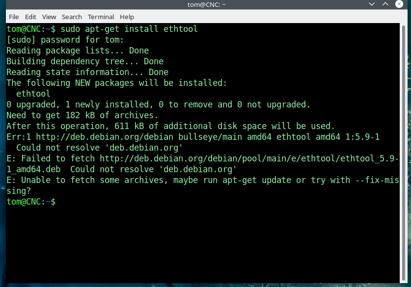

Ok I tried but I seems the controller needs to be hooked to the web see attached screen shot.
I will lug the controller inside soon.

Replied by rodw on topic I need an answer
Yes, when setting up a PC, live is much easier if you bring the PC inside and connect it to a wired network connection. Don't be tempted to use wifi. It might work if you have to but wifi is a lot slower than wired.Ok I tried but I seems the controller needs to be hooked to the web see attached screen shot.

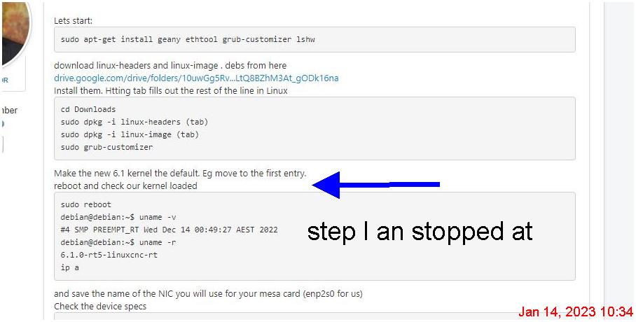

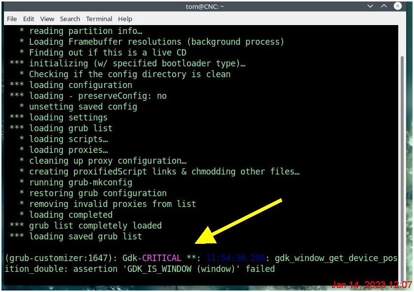

Ok I have made progress with changing the driver, but have hit a wall. I an not very Linuxcnc knowledgeable but I am learning. Following the link that RodW posted above, it seems I an not entering the correct step. I get into grub-customizer and try to load the new NIC driver as shown and I get an error. I may be using the incorrect terms but I'm a newbie ): ): please indicate what I am doing wrong.

Replied by andypugh on topic I need an answer
This looks like a graphics problem of some sort with grub-customiser.
Maybe skip that stage for the moment, and select the required kernel at boot time.

Replied by tommylight on topic I need an answer
No need to select anything, it is the first choice by default as it is the highest kernel by number.
There was also no need for grub customizer, but to late!
After boot, in a terminal, what does
uname -a
return?
uname -a
return?

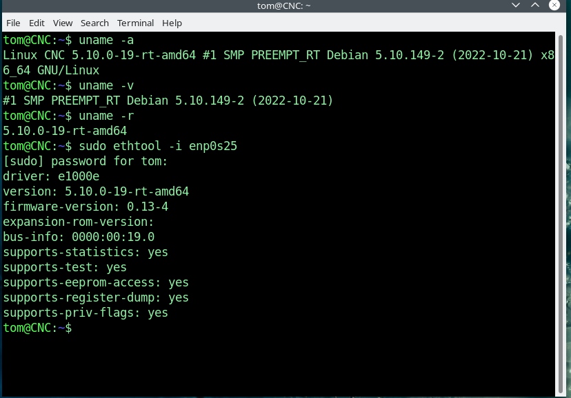

It shows the 5.10.0 still in there

14 Jan 2023 20:49 #261981
The network driver is an Intel e1000e so its not a realtek card.
Have you experienced an error finishing read when using your mesa card?
If not, you probably won't need to update the kernel.
If you do, grub-customizer is really just a convenience. You can update-grub without it. I am a bit rusty on how to do it so someone else would be better equipped to help
In the meantime, when the grub menu is displayed at boot time, press the down arrow and select the new 6.1 kernel for now. You may need to open a menu to see alternatives by hitting enter on the second entry.
