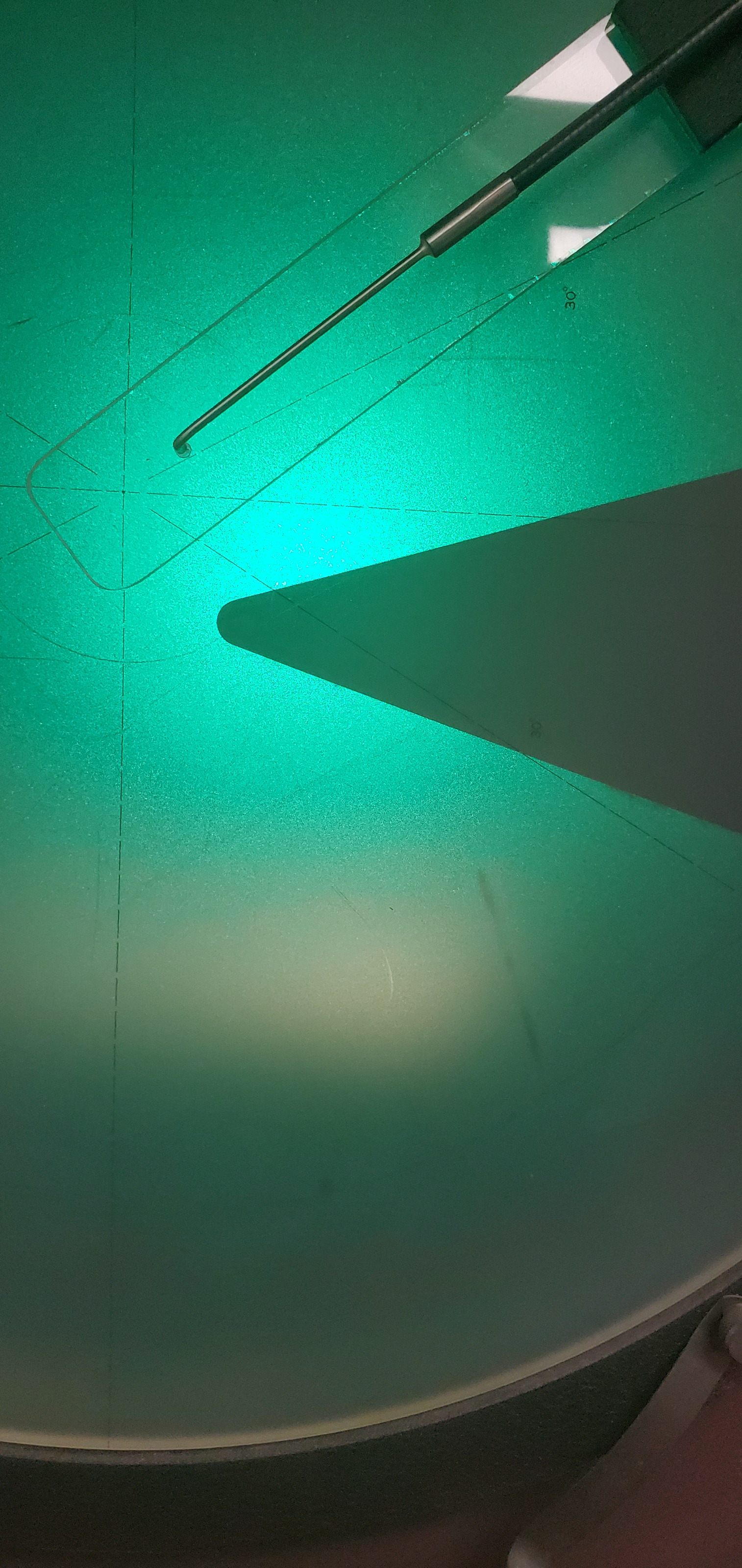

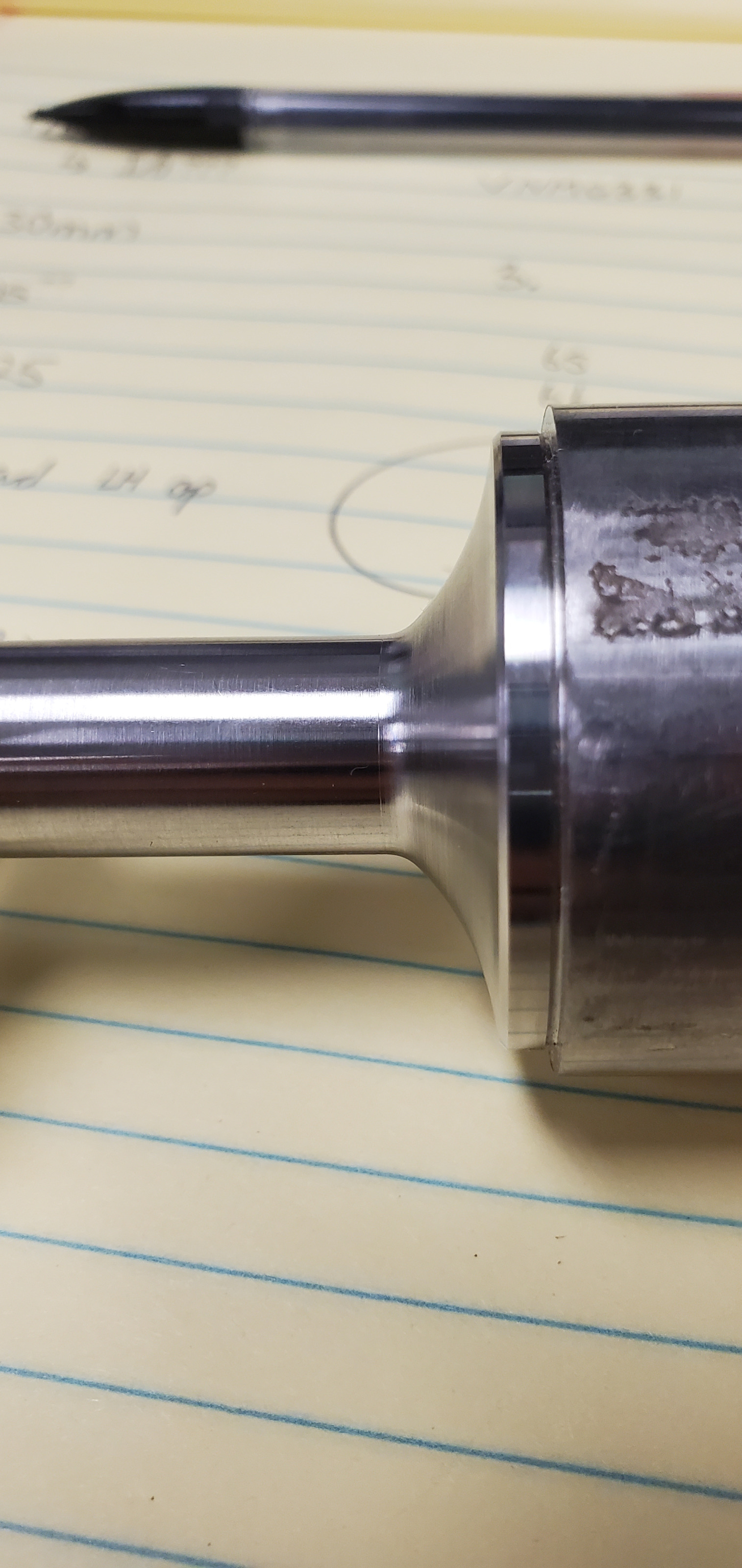

Hello,
I am having difficulty achieving tolerance machining a .750" +/-.005" radius. My lathe has stepper motors with micro-stepping drives, Mesa FPGA and daughtercard. I have measured x and z axis ball screw backlash and entered compensation values(both are less than .001"). The lathe has been able to consistently achieve /-.001" tolerances on diameters and Z lengths.

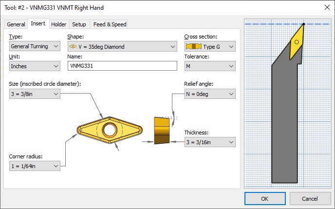

I am using Inventor CAD/CAM to generate g-code with a linuxcnc post processor. Not using control cutter compensation. Tooling is VNMG 331, material 316SS with coolant. Cutting speed is 300fpm and fpt is .005". Tool origin is tip tangent both x and z.
I verified that the G2 arc move on N66 should produce a .750" radius with a 1/64" tool radius by laying out in CAD. I am measuring the part radius with an optical comparator that has been calibrated against a radius gauge.My radius measurements have been all over the place from .720" to .740" with the optical comparator(measuring the same radius).
I am wondering if my arc profile is more like a series of line segments and the comparator gives me the best fit radius depending on the points I provide. Small deviations in point data result in large radius error?
Is there a trajectory planning setting that I haven't set correctly somewhere? Is +/-.005" tolerance on a radius a reasonable expectation?

I was not certain of my tool radius. It has a class M tolerance which I believe is .002-.005". The insert radius measured .0167" on the optical comparator. I will lay this out in and see how much .001" makes on the resultant radius.
The part I am making is a qualification test and the radii have a /-.005" tolerance. The first test piece I submitted was rejected for the radii being out of tolerance .005" and .010" respectively. All other dimensions were in tolerance. I want to insure that my second submission passes inspection. I do not know what measurement method the lab uses to qualify samples. I suspect CMM but the only method I have is optical comparator. I agree that normally radius tolerance is not critical.

25 Feb 2023 12:49 #265323
Replied by andypugh on topic Lathe G2/G3 arc move path inaccuracy
Try taking out the backlash comp, see what happens then.

It seems odd to me that the amount my radius is off is almost exactly the tool radius for VNMG331.

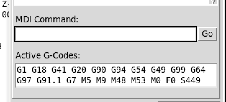

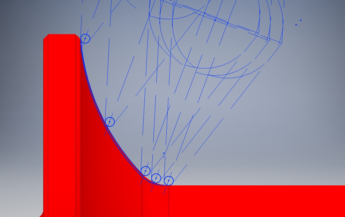

28 Feb 2023 20:41 #265608
Well, I am no less baffled than before....
The actual radius of the controlled path is 0.734 (dotted in the picture) and that should (based on three little tool tip drawings and a tangent arc) give a .7497 radius arc.
I have two things left to try, but they are rather clutching at straws.
1) Try setting the tool radius in the tool table to zero. Just to be entirely sure that LinuxCNC isn't trying to do cutter comp.
2) Try adding a G40 to the G-code to make even more sure that it isn't doing cutter comp. Though if G41 or G42 were active they should show up in the active G-codes display.
