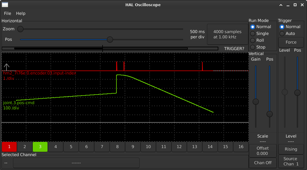

I'm trying to get a rotary joint to home using an encoder index.
I would expect the motor to rotate (according to the 'HOME_LATCH_VEL' set in the ini and upon finding the index pulse stop and reset the absolute position to zero.
What I see is the motor starts turning finds the index and then returns to, what seems to me, the old absolute zero position.
This is on Version 2.9 from a recent bookworm install.
Any ideas?

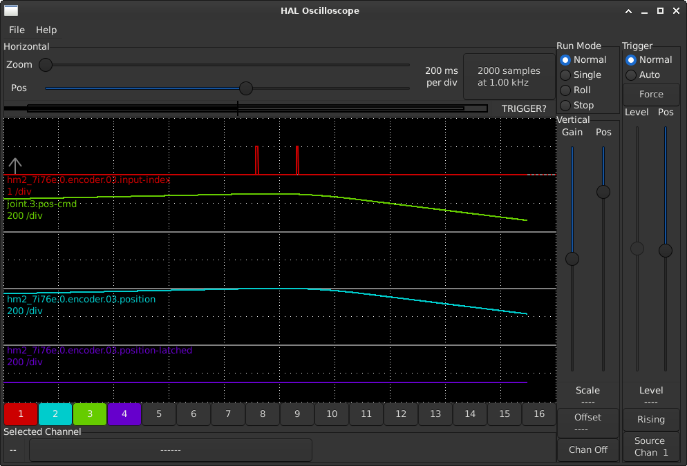

Here is a HalScope shot with the encoder positions.
Rotary:

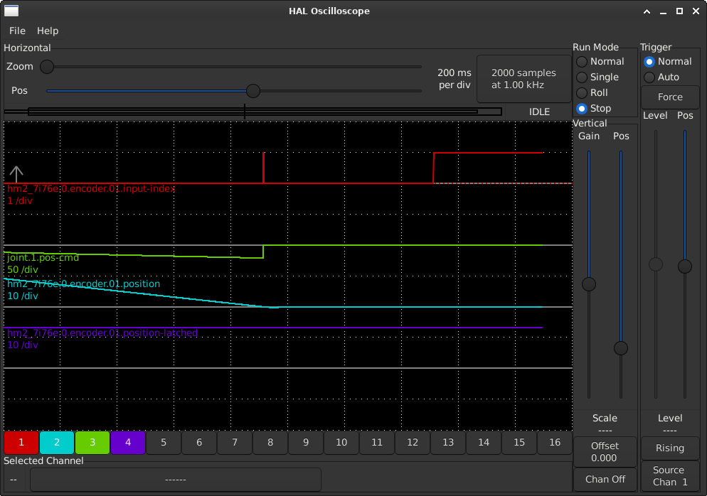

And my (linear) Y axis also using an index:

So it seems to me that with the rotary homing the joint position is not set to zero.
21 May 2023 14:00 #271820 by chris@cnc
Replied by chris@cnc on topic Rotary axis homin on index not working
I seems your encoder feedback is missing?

21 May 2023 14:30 #271826 by Aciera
Replied by Aciera on topic Rotary axis homin on index not working
Ah, yes the linear axis is indeed closed loop and the rotary is not since that runs on a servo controller. So does that mean that I have to fully close the loop for that rotary in linuxcnc to be able to use index homing?
I was hoping to avoid that since that would mean two positional pids in the system.
21 May 2023 14:45 #271830 by PCW
Replied by PCW on topic Rotary axis homin on index not working
It is possible to home open loop stepgen systems to index using
the right firmware (firmware with step/dir index support)
This firmware exports a stepgen index enable pin and has stepgen
hardware that emulates encoder behaviour on index. The stepgen index
input is normally shared with encoder index inputs of the same channel
so you might have to re-arrange stepgens for this to work.
21 May 2023 14:51 #271832 by chris@cnc
I set the linuxcnc PID to 1 and tune the servo controller. It works...
