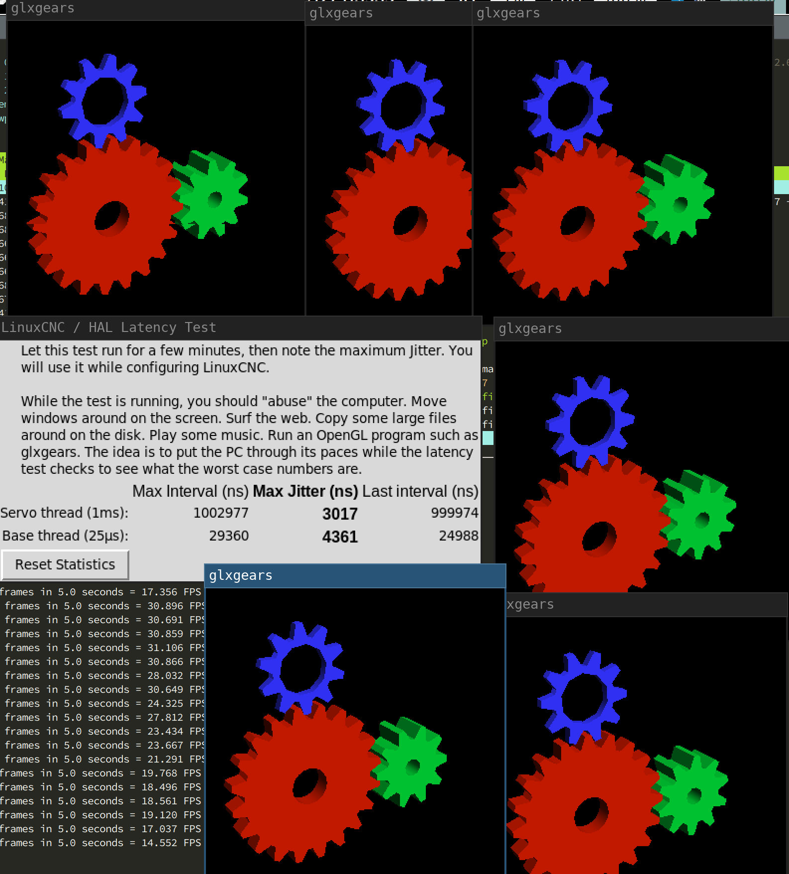

Replied by grandixximo on topic How to fix "Queue is not empty after probing"
abs32
can you share a screenshot after running on your system
latency-histogram
for a few minutes with a few glxgears running?
latency-histogram

27 Dec 2025 08:17 #340575
by abs32
Replied by abs32 on topic How to fix "Queue is not empty after probing"
да пожалуйста.
According to my observations, the queue error simply replaced the error Probe tripped during non-probe move.

28 Dec 2025 06:23 #340614
by grandixximo
could you run
latency-histogram
instead of latency-test?
I think you might be onto something, I use a custom version with probe tripped during non-probe move disabled, and I never see queue error...
latency-histogram
