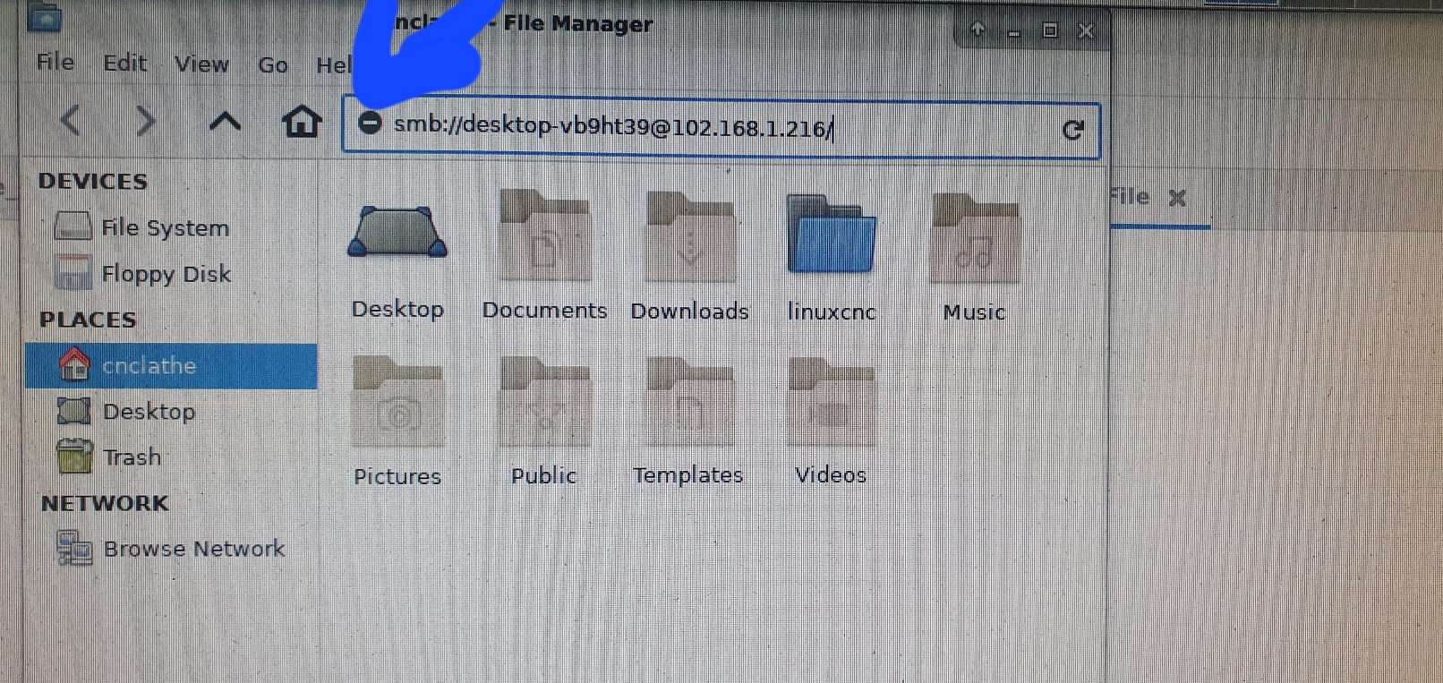

Okay it would be too nice. I have to have a problem on my lathe Linux pc.
It seems that the thunar file manager cannot use links or so.
as soon as I enter smb: and // i get the icon that shows that the link is not allowed next to the link (with link I mean the windows username and ip)
I did already "sudo apt-get install samba" in the terminal.
update: I did this from here superuser.com/questions/1645590/thunar-cannot-browse-network and now I can enter the link and I get the password pupop. I enter the correct password but shortly after
I get "Failed to open file system. Failed to retrieve share list from server: no route to host"
I will continue, maybe I get it done somehow:)

Everything is working now.
I had to unplug a couple of LAN cables and reorder them and i somehow managed to unplug the windows lan cable thinking it was a unused one.
Stupid mistake.
File sharing is working and i am super happy.
Thanks and nice sunday, once more.
