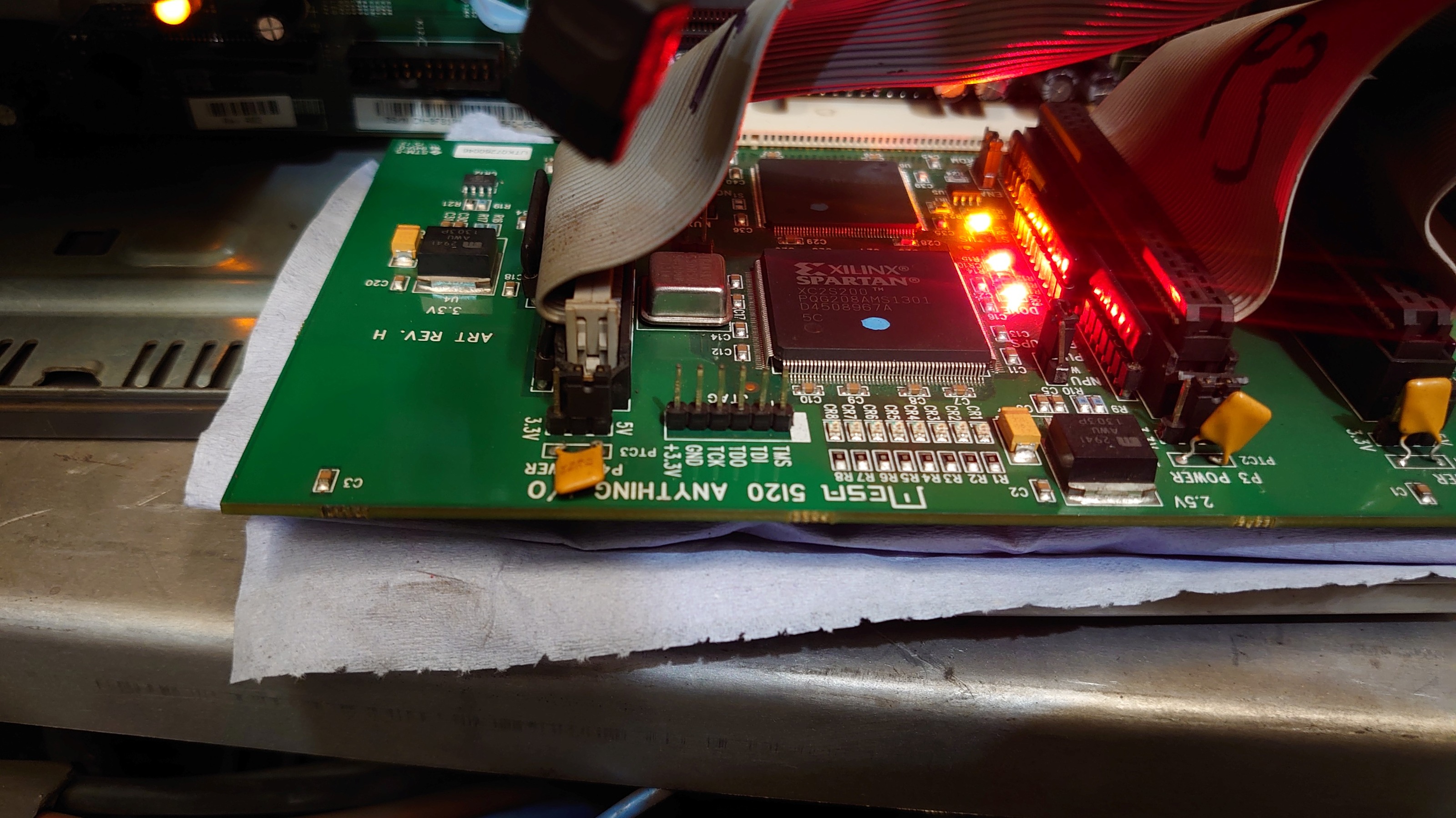

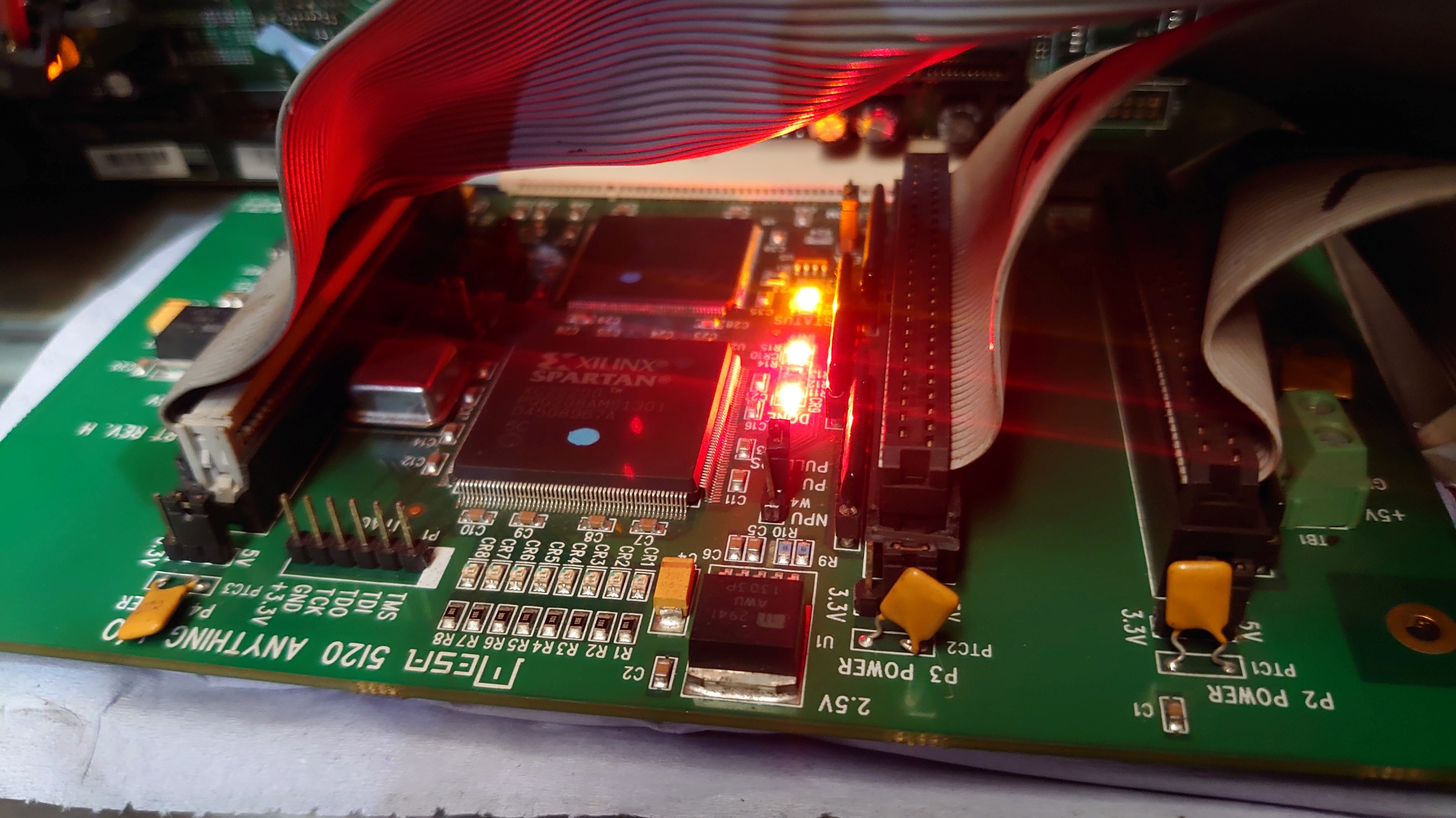

- Posts: 18063
- Thank you received: 5308
10 Apr 2024 13:56 #297926
Replied by PCW on topic Issue on boot
insmod: error inserting '/usr/realtime-2.6.32-122-rtai/modules/linuxcnc/hm2_pci.ko': -1 No such device
Means the card (5I20?) was not found (no valid cookie read from card)
The two red lights should go out when LinuxCNC starts and loads the
selected firmware into the card.
It may be that some PCI setting was lost when the CMOS battery failed,
a bad PCI/dirty slot. or failed 5I20 card, hard to tell without more data.
If the 5I20 card is bad, the most compatible replacement would be a 5I24
This would need to have similar firmware installed and the card name
in the hal file changed from 5i20 to 5i24.
The following user(s) said Thank You: cncsparko

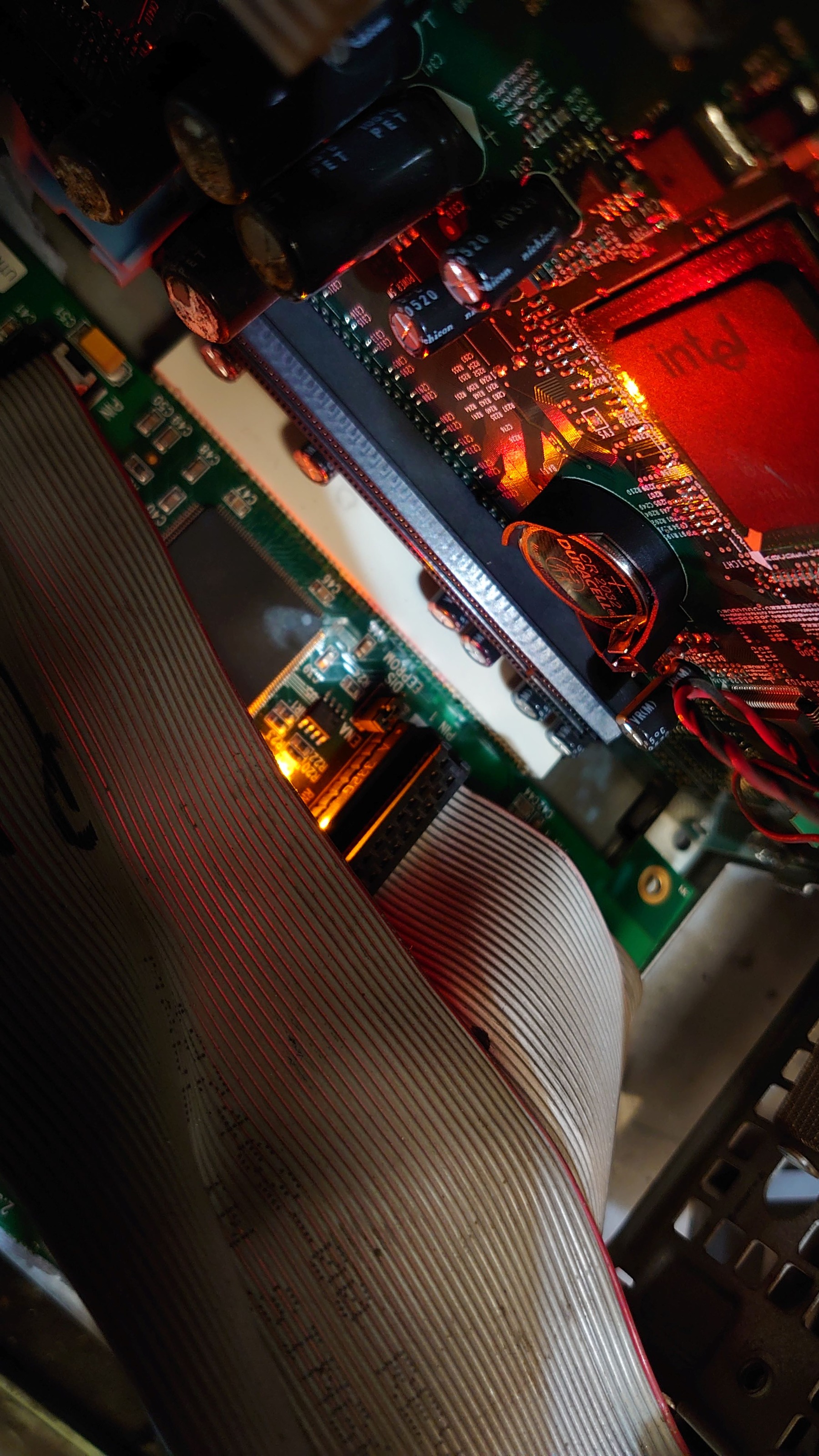

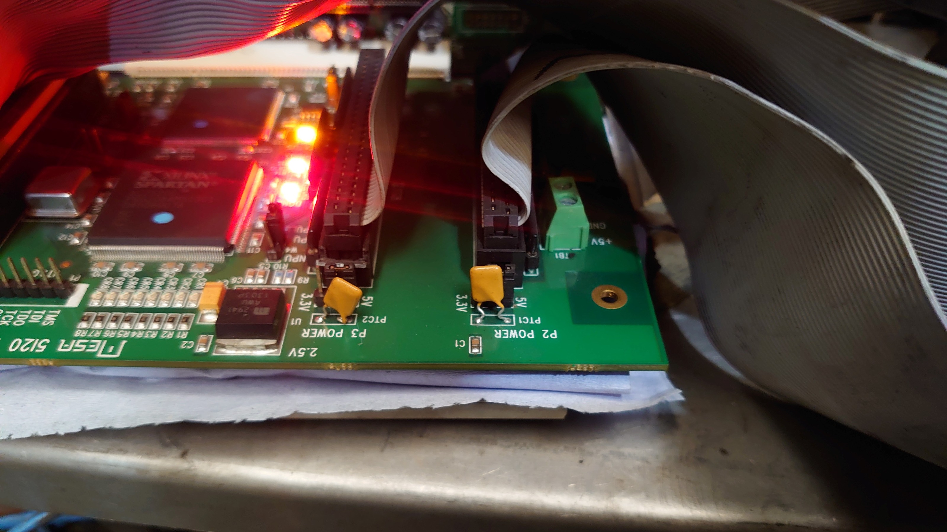

- cncsparko
- Posts: 12
12 Apr 2024 13:43 #298068
by cncsparko
Replied by cncsparko on topic Issue on boot
Pics of card and Pins etc all for the MESA 5i20 on the back.
only 2 sets are without the bridges connectors, one under the ribbon lead on the left and the long strip out the front.
