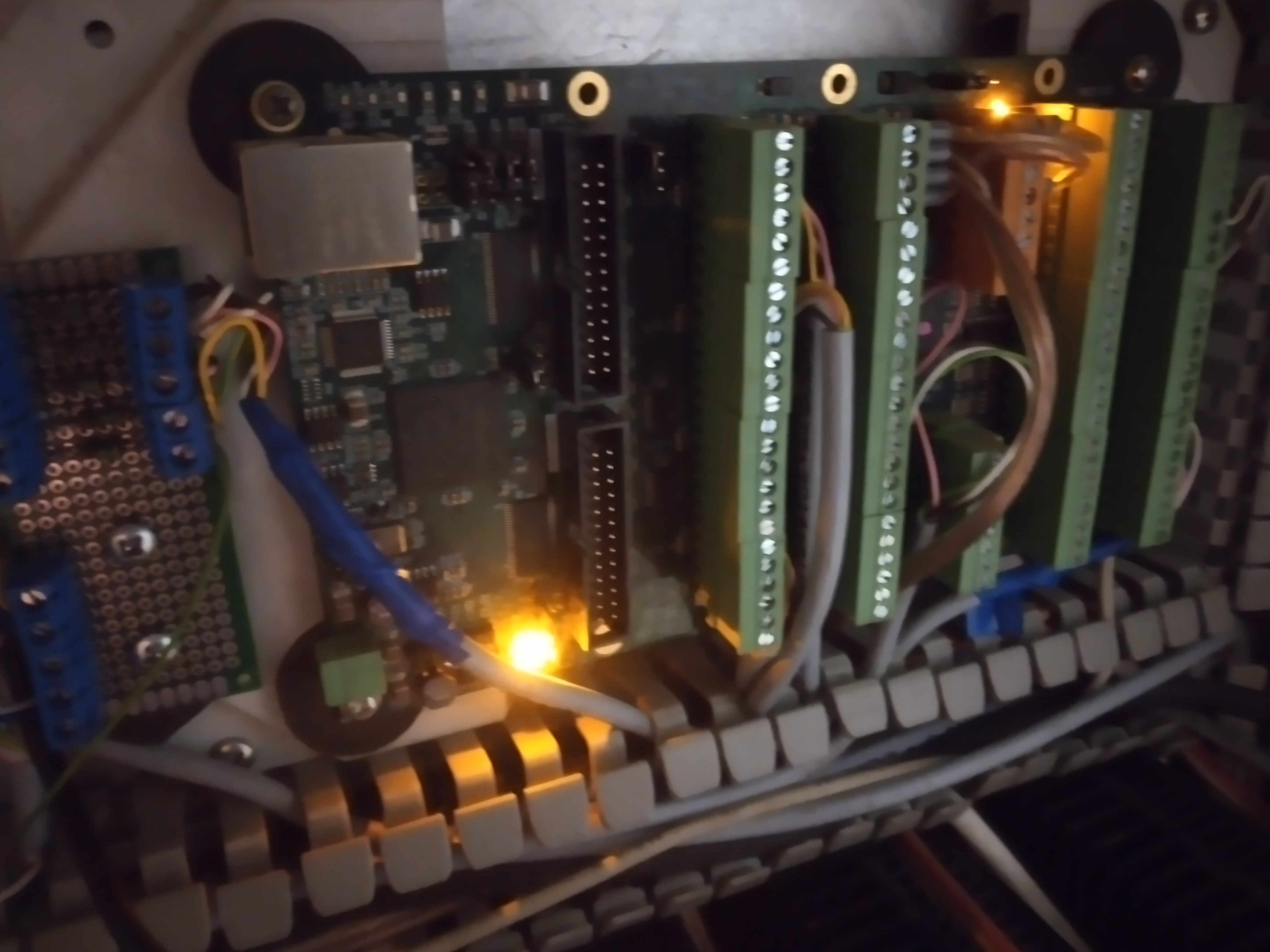

Hello, hope someone of you can help me.I have 2 machines defined on one mesa 7i76e card a mill and a plasma cutter. Both was working well until an error came up. In the most cases an reboot of hard and software fixed all the troubles I had so far. But this one seams to be different. On rebooting on both of the machines I get the same error (please see the attached file) Hopefully I have no hardware damage.Thanks for your afford in advance. BR. Tom

Can you check if get any LEDs illuminated on the 7I76E RJ45 connector

- __Tom
- Posts: 20
18 Aug 2024 16:47 #308087
by __Tom
Replied by __Tom on topic Getting an error on starting a machine
please see attchments
