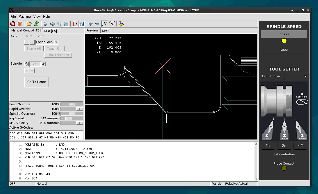

Presently in Axis simulation mode, so the GUI looks much the same as what I see on my mill. How do you configure Axis so it knows the machine is a lathe?
Replied by slowpoke on topic LinuxCNC for lathe questions
Progress, I have LinuxCNC up and running on a Pi4.Same same. Active "Axis UI" Gaga here!! 2ax LATHE, and also MILL. I'd use nothing else other than Axis even if paid or tortured. Sure a few will promote other UIs, but don't believe them, they are terrible influence

Replied by Aciera on topic LinuxCNC for lathe questions
in the [DISPLAY] section of your ini file add
LATHE = 1
LATHE = 1
