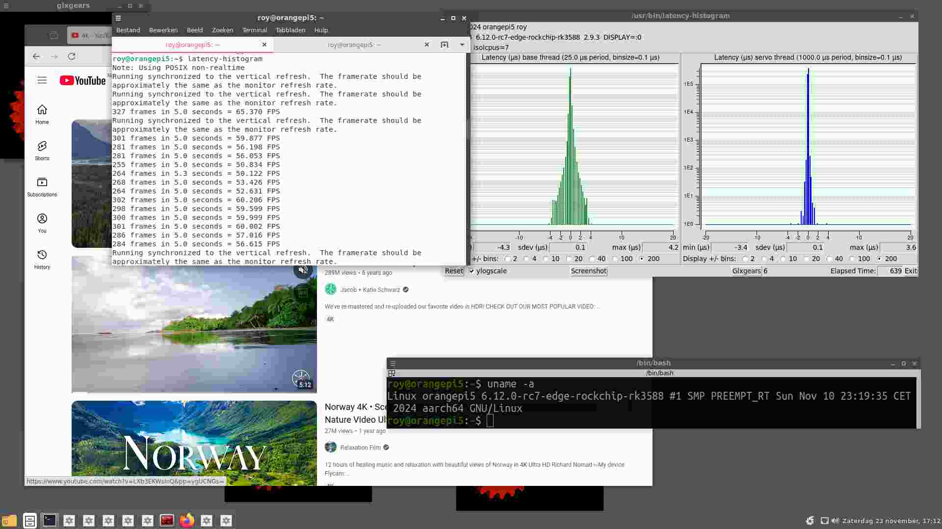

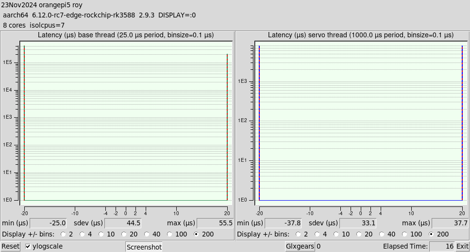

I've compiled Linux 6.12 with Full real-time enabled, but somehow it's not detected as real-time by LinuxCNC. When I set the priority manually at RT via "sudo htop" and press I, the latency is low so I'm sure that it's compiled correctly.
Perhaps the detection method need to be changed?

6.12 should have Preempt and it can be actvated with PREEMPT=FULL at GRUB.
Did not test on 6.12, on 6.11 it would ignore the above.

As you can see in the screenshot it's configured with fully preempted. Are you sure that this kernel parameter makes it real-time? Isn't this only to make it low latency when the kernel is configured is dynamic?

Nothing on the screenshots says it is a fully preemptible kernel in use, and it is also noted by LinuxCNC in the terminal saying "using posix non-realtime".
Why the report? You already said that here and it was not changed (the tittle) as there is no evidence the normal AMD64 kernel also does the same thing, both screenshots contain only Orange PI.
Instead, try patching the kernel again and choosing fully preemptible in menuconfig (was it called that?) ... but then again, why patching, there are ready made debs for AMD64 with RT patching already done, no idea if there is one for OPI though.

In the other terminal you can read "PREEMPT_,RT".
In the screenshot of the whole screen (where I put the rtapi processes manually on the FIFO scheduler with rt priority) you can see from the result that it's definitely a realtime kernel, but somehow just not detected correctly since 6.12.
Do I really need to send a proof that it's the same with x86?
It's a bit annoying that the title got changed to something that attracts less attention, while it's not even limited to only that device/architecture.
Since you didn't reply on it but you did reply on other topics in this section I assumed that you didn't read it. So by trying to prevent of getting a lot of noise in this topic (didn't work) I pushed the report button.
