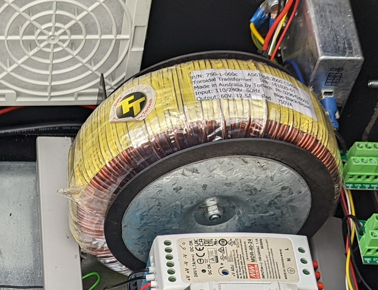

I bought four Rteligent R86 stepper drivers because they easily exceeded my needs as I understand them.
I will attach the Docs for the curious.
This driver offers the option of either AC (20-80v) or DC (24-100v)
Obviously if I went with AC I would need a transformer similar to this one:
www.digikey.com/en/products/detail/hammo...ng/166G80/270170It's listed as 115vac to 80vac Max-current 500 mA Max-power 40VA.
My question is what advantages / disadvantages does AC have over a 72v DC supply?
The only thing that occurred to me was maybe smaller gauge wire or lower loss for longer supply cable runs vs DC.
Neither seem important enough for them to include that as an option unless the driver itself prefers it and they don't mention anything on that topic in the documentation.So I'm wondering if anyone in the community has experience with the AC option on a stepper driver?

I used one of these 60v AC toroids for my Rtelligent ECT86 drives
I had a couple of these custom made for another project.
Toroids are generally preferred for steppers.
Often a toridal power supply for steppers will include a DC recifier.
This is unecessary if your drives accept AC and it also simplifies the wiring.
I'm not sure of the internal circuitry of the drives, but somewhere the voltage must be converted to DC to operate the steppers
converting AC to DC steps up by a factor of approximately 1.4 so this 60 volt gives around 84 volts.

Oh, and I forgot to say don't go to the maximum voltage. look for something in the 50-72 volt range so you don't push to the limits.

Normally you get ac input drives for high voltage and no need for a psu. Just plug into mains.
At 80v this makes no real sense cause you'll need a tx. Just use a dc supply instead because internally all the drive is doing is converting your ac to dc.

No need. Just get one that is correcty tapped for 110v and 220v input. The one I showed has inputs for 110v and 240v. It did not cost me anymore.Thanks for the info!

Use whatever you like, at such low current/power ratings there is no difference nor "proffered", it is as simple as what is cheaper for you since you have both options and you do NOT need a rectifier as it is in the drives.
ALSO: the link you posted will NOT work, it is a 40VA so approx 30W transformer, you would probably need something like 200-600W depending on what current the motors will be driven.
In general for you it is better to get a transformer as a good switch mode power supply will probably cost more, like MeanWell or Delta.
just browsed under, NO variacs!!!
And if you do not have the drives , take IhaveNoFish's advice and buy the mains ones.
