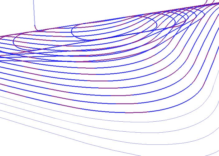

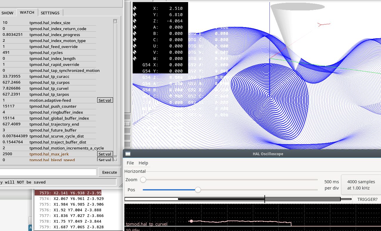

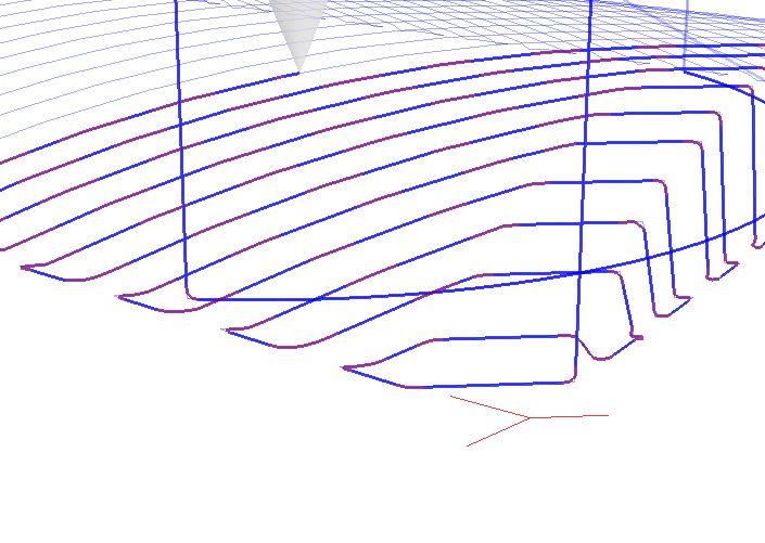

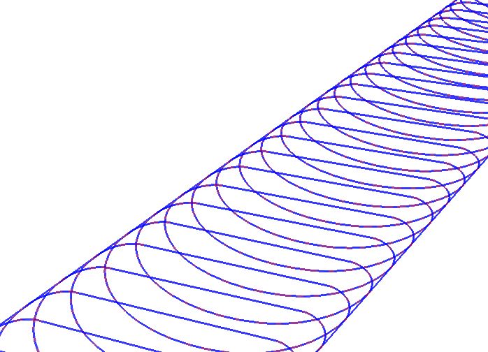

Hi all,
* Note, the topic name was changed up to 2 times by someone, haha.
Today i added look ahead. This took almost half a day. It's a tiny file, but took a lot off time.
Here is the look_ahead_source_code_file
Now i did a test run tonight using a line fillet algo : file_path_standard_subseg_line_fillet
This is a simple optimizer algo, that is handy for simple runtests.
The test is done on the extreme spiral_on_surface file. With tiny segments 0.001mm and deviation P0.0001 Q0.0
Some hal values:
Git sources are updated.
The first donation is recieved. Thanks ! See the github readme file for more info !
Some hal values:
- incements_a_cycle = 2 (planner skips extra gcode segment to keep up with scurve new position)
- ring buffer size = 10
- total loaded segments from program start = 15117
- future buffer, items that are ready to perform, including fillet segments = 3
- cycle dist, is the distance in mm for current servo cycle = 0.0078 mm
- hal traject buffer dist, total todo segments length. ( sum off future buffer ) = 0.1544764 mm

Hi all,
Today i did a test using the clothoid algo.
It turns out, when doing a fast clothoid fit, (using deviation as trim dist) this takes around 0.5ms.
Everything is going well.
When using the excact clothoid fit method, it takes time up to ~200ms when it has difficulties to find a fit.
I will find a solution for this later on.
Most off time the clohtoid fits are ok. I have seen cases where the clothoid fit result looks like overfitting.
This could be investegated later on.
Here some 3d clothoid fit examples. Using look ahead = using endvel.
So far i am happy with the results.
Github is updated.
