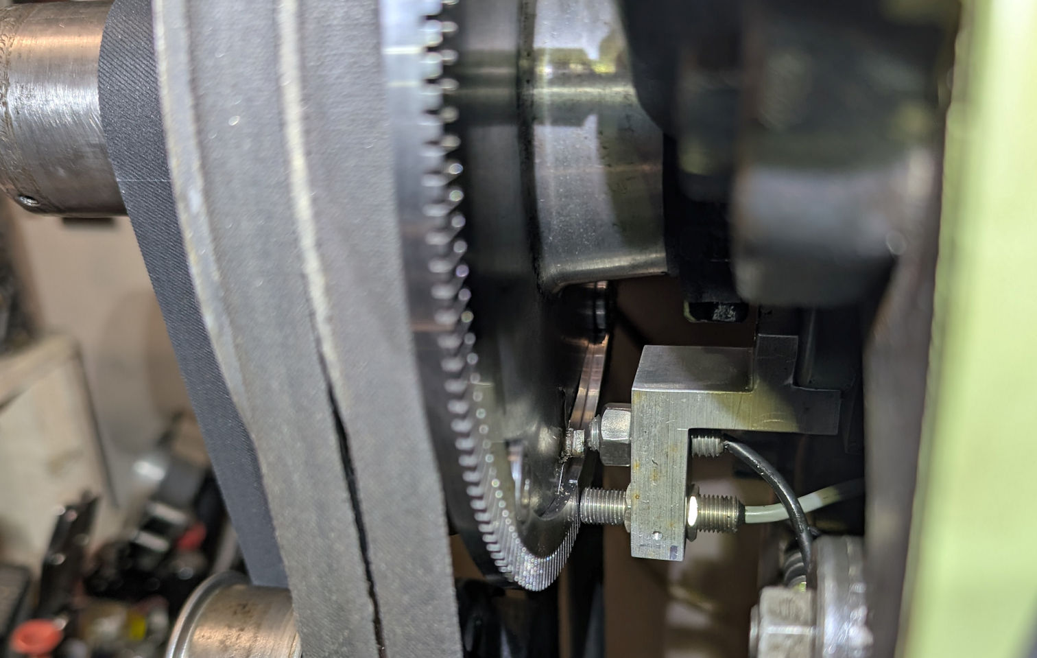

My lathe spindle originally had an Index pulse and 10 encoder pulses per revolution. From the problems discussed in
forum.linuxcnc.org/38-general-linuxcnc-q...peed?start=40#319800
I thought it would be better if I generated more than 10 pulses per spindle revolution.
I built a ring to fit on my lathe pulley with 180 teeth. I picked this size because it had the most teeth that I though I could machine. They were about 1/16" width and depth. I found that the proximity probe I was using could not detect these small teeth. I replaced it with a Hall Effect Sensor =11.0ptS38J-22ADSO-5KJA5 from Standex Electronics. Here's the installation:

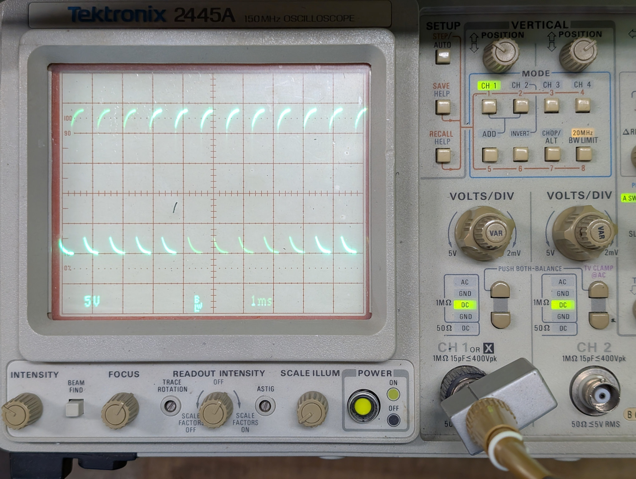

Here's what the output looks like at 400 RPM on my oscilloscope:
This is about 24V. The frequency of the signal is about 6 cycles in 5 mS, or 1,200 Hz. Expected signal is 180 pulses * 400 RPM / 60 = 1,200 Hz. So far, so good.
The signal goes into a breakout board with optoisolators. I can see the signal on the input and output side of the optos, so I know it's going into the circuit OK. I don't see any missed pulses on the oscilloscope. The breakout board feeds a Mesa 7i92.

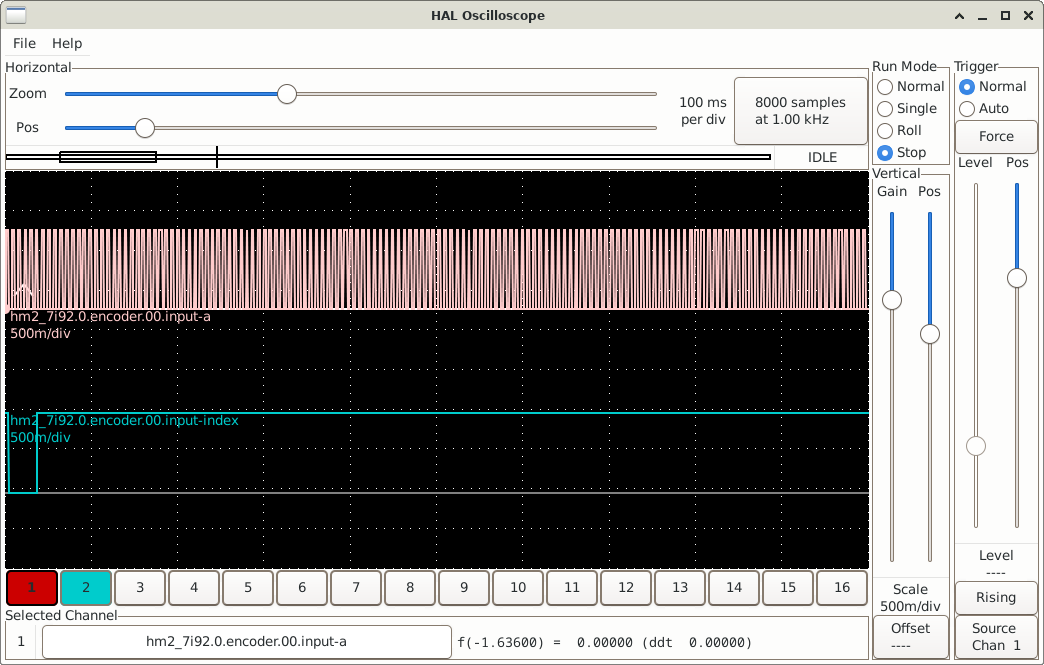

When I pull up the encoder inputs in HalScope, I see:
Not good. I should see 180 pulses between the index pulses. I'm seeing about 10. Plus, one of the index pulses is missing.

Slow optocouplers.
Better quality BOB should help, or just get 2 fast optos.

Replied by PCW on topic Spindle Pulses Lost in System
Halscope (and a software encoder) cannot reliably "see" pulses shorter
than the sample period (4 ms in this case).
That would be fixed by using firmware with a hardware encoder and using
the hardware encoder rather than LinuxCNCs software encoder component.

Replied by tommylight on topic Spindle Pulses Lost in System
Why is your hal scope running at 250Hz? It usually runs at 1000Hz.
And yes, i had issues with cheap BOB's so i stopped using them, some could not do 5KHz properly, but i do have one that uses no optos and is very fast but consequently lacks isolation, hence it also collects dust in the shop.
Some things to notice, BOB's are almost always 5V devices, putting 24V encoders on the inputs might not be healthy for the optos, but again, depending on how they are wired, might also be perfectly OK.
How do the pulses look on the output of optos AND Mesa inputs?
