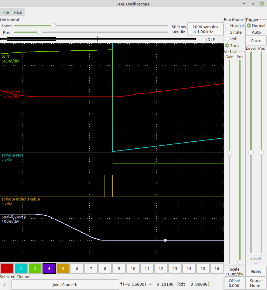

I was able to reproduce this error with a simple test setup
with no mechanics and using g76. It also causes errors even
at a constant spindle speed, as the offset changes with thread
depth over the multiple threading passes which would cause
a wider than expected cut.
To test this I setup a 7I96S with a stepgen spindle setup to
emulate a 8 count encoder with index (using the stepgen table mode)
I checked the offset by using the sum2 component to scale the spindle
rotations to the thread pitch and subtract the result. This offset
should be independent of spindle speed, X,Z motion constraints
and drive line distance to thread pass, but it is not.
Have you raised an issue on the LinuxCNC github page?

In your constant speed example, is there any possibility that what you are seeing is the "virtual compound angle" Q ?
Replied by andypugh on topic Threading Index Varies With Speed
Which LinuxCNC version? Not being able to cut threads would be a huge problem.It also causes errors even
- Posts: 18118
- Thank you received: 5336
25 May 2025 11:22 #329116
Replied by PCW on topic Threading Index Varies With Speed
Yes, you are right, there is no error on multiple constant speed
paths, I had neglected to 0 the q parameter when testing.
This is because the return path has a constant x distance from
the cutting path.
You get the error if you change the spindle speed (or motion constraints)
Basically I would think the the z motion should be strictly geared to
the spindle (+- any deliberate offsets like "q") just like a mechanical
lathe.

- Posts: 18118
26 May 2025 15:39 - 26 May 2025 15:40 #329179
Last edit: 26 May 2025 15:40 by PCW.
