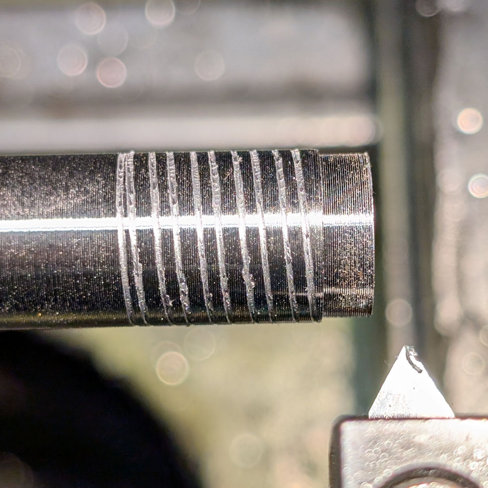

This problem, and this forum thread, all started when I was getting gouging when making a 1"-8 thread. After analysis, I believe that the lathe was bogging down slightly when making later passes in the increasingly deep thread. I've confirmed that the position of the thread changes with speed. The slight decrease in speed made the cutter take a larger bite, which caused further bogging down and then an even larger bite. Eventually, the lathe reached stability and was able to speed up and quit gouging.
Today, I tried making the thread again. I kept thinking that the Monarch lathe motor is large (7HP), and should be able to power through the threading cuts. My lathe has a back gear (speed reduced, torque increased), which I have never used. I put the lathe in the back gear and tried the thread cut. The gouging stopped completely. So that problem is solved to my satisfaction.

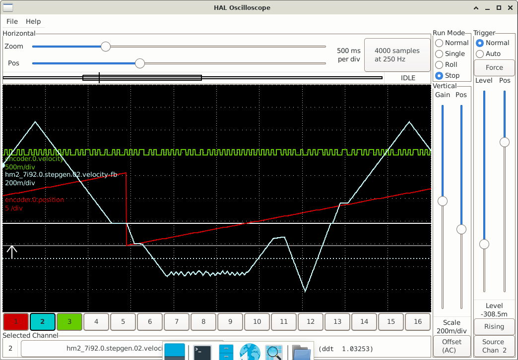

First, I looked at the interpolated and raw signals in HalScope. As expected, one had jaggies and one didn't. In my INI file, I changed:
net spindle-position encoder.0.position => spindle.0.revs
To:
net spindle-position encoder.0.position-interpolated => spindle.0.revs
I ran the threading program at 200 RPM:
Jaggies gone, plus initial slope change before threading now a straight line. However, there's a break in the velocity midway on the line that was not there before. Still have the odd saw-tooth velocity while threading. (Note: I was running the program without a tool, so no actual threading took place)
I thought this might have fixed the problem. So I made another 8TPI thread at 100 and 200 RPM. Alas, they did not overlay. Same problem. In case you're wondering, I could not find another piece of 1" stock, so I used a 1/2" rod.

Could you plot the encoder position and velocity to see if the error is from the encoder side or LinuxCNC?
The jagginess may be from encoder wheel inaccuracies and inherent velocity quantization
errors from the 1 ms time stamp of the software encoder (this would be improved by using the hardware encoder)

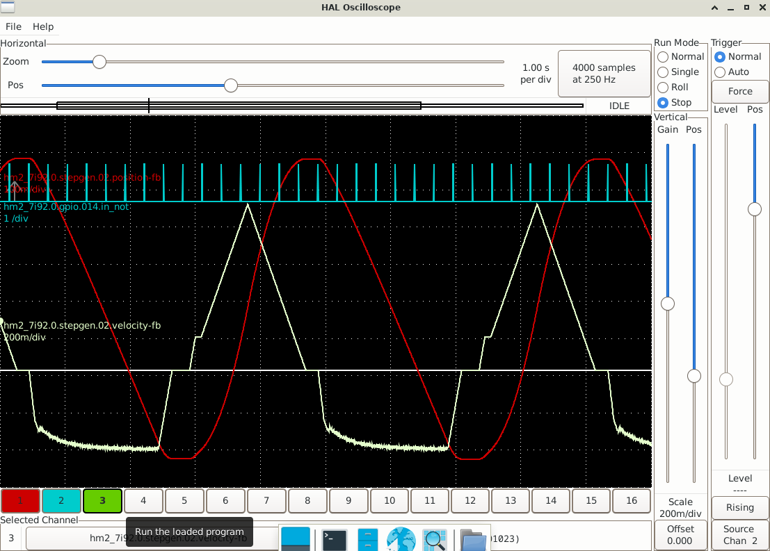

Take a look at this plot:
There is something pathological here as the Z velocity is never constant,
having a slow exponential rise, so the thread does not have a constant pitch.
This is not due to the acceleration constraints but either a hardware/encoder
bug or bug in the threading code.
This is why I asked for a plot of the encoder position/velocity, to determine if this
is a LinuxCNC threading bug or hal/encoder bug.

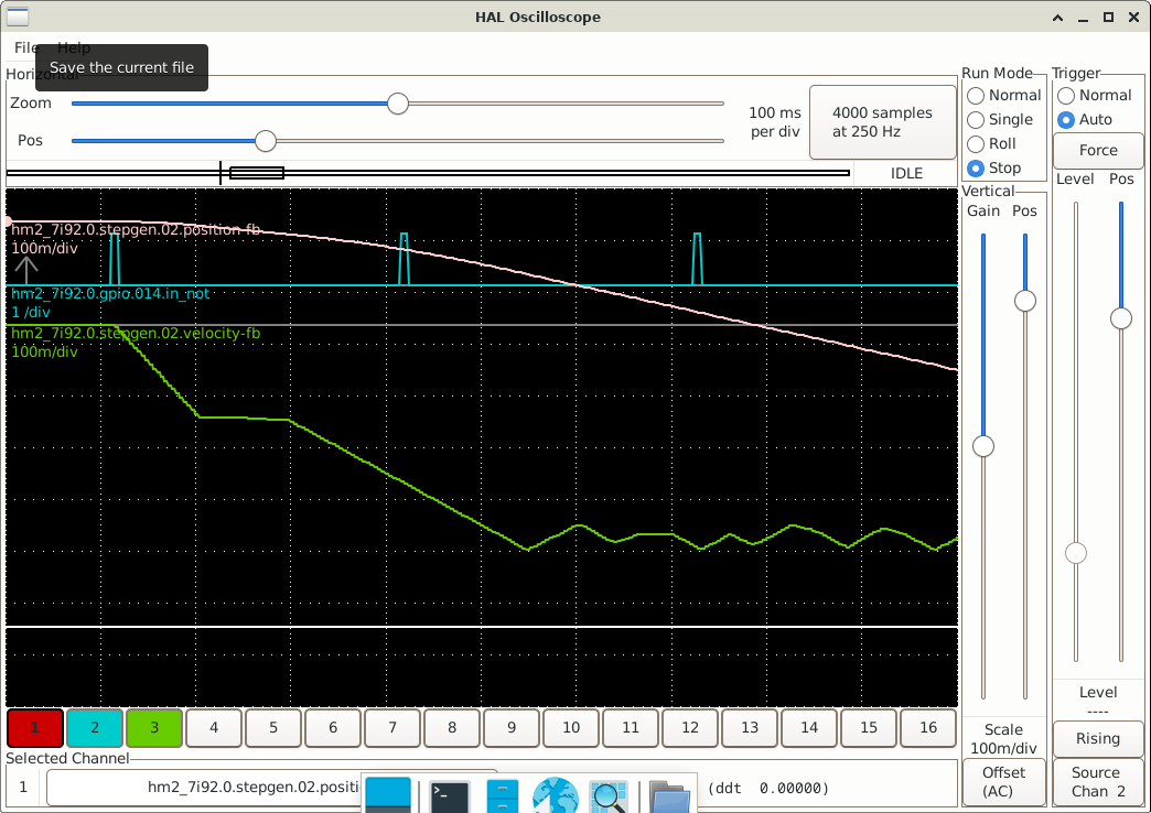

Here's the plot you requested:
This cut is slightly different from the previous ones, as it has a tapered exit for the thread.

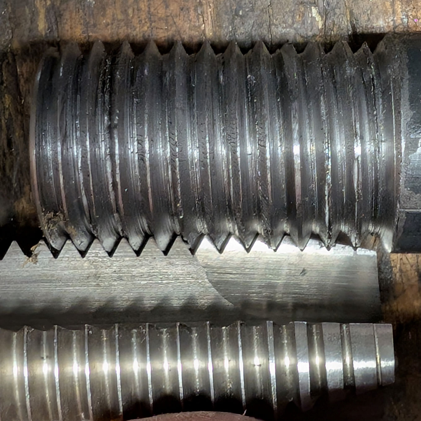

The comment about the non-constant exponential threading velocity got me thinking about the threads I cut. I made six. On about half of them, I had to rerun the program because there were tight spots in the threads and I could not easily get the nut on. Running the program a second time, at the same speed, still resulted in some cutting near the bottom of the threads.
I laid the treads up against a 8TPI tap. About half of them look OK, and the tap will sit in the threads without wobbling. The other half, the tap wobbles, or see-saws. Here's a photo of one of those. You can see that the tap is touching on the left side of the thread on one end, and the right side on the other. The reason some of them are OK might be because they were run twice. I don't recall which are which.

31 Dec 2024 12:46 #317730
Replied by PCW on topic Threading Index Varies With Speed
Well, naturally, that looks normal (no exponential/varying thread pitch)
Was that at 200 RPM?
